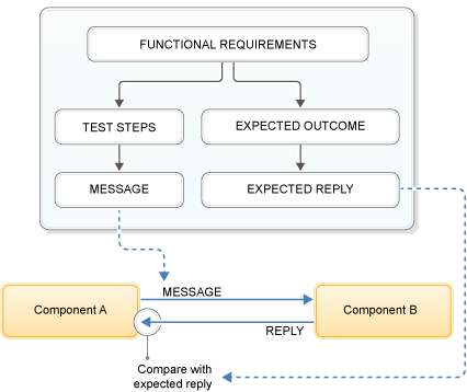

The test execution process consists of the following steps:
  1. Create test steps that include a send message action and a receive message action.
  2. Set the expected message outcome in the receive message action.
  3. Trigger the send message action that is, sending the message or messages to the SUT.
  4. Capture the reply from the SUT.
  5. Validate the received message against the expected message and point out any differences.
