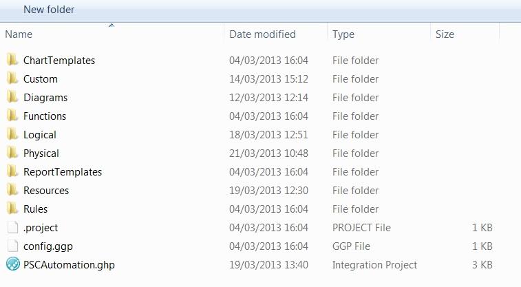

Project structure
When an HCL DevOps Test Integrations and APIs (Test Integrations and APIs) project is created for the first time, the project folder structure is created on a disk.
Project structure

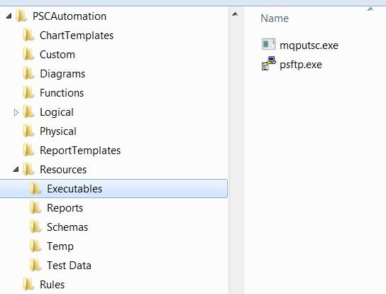

  • Make sure that projects are as self-contained as possible. Moving project locations must not break tests.
  • Create new folders within the project folder to store artifacts, such as schemas, test data, executables, Apache Ant scripts, and reports.
    Executable structure
  • Where possible, put the schema source data into a project. This helps with portability of your project.
