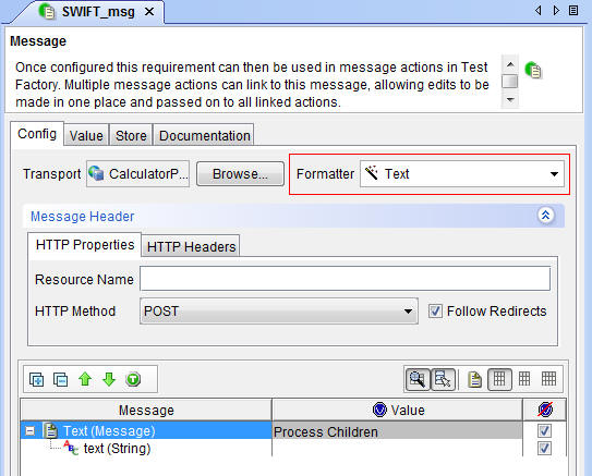

Right-click a project or operation, and then click .
A blank message is displayed.
Set the Formatter field to Text.
Right-click text (String) in the
Message field, and then click
Schema.

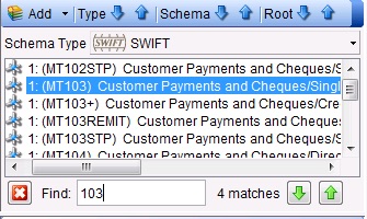

The Schema Selector dialog is displayed.
Click the Schema Type field in the Schema Selector dialog, and then select .
The SWFT schemas that you can apply to the message are displayed.
Select a SWIFT schema from the list in any of the following methods:
- Select the SWIFT schema that you want to apply.
- Select a SWIFT schema by a number rather than a name by performing the following steps:
- Select one of the displayed roots.
- Press Ctrl+F.
A search field is displayed.
- Type the number or other identifiers for the root.
For example, you can enter 103 or 103STP to find entries that have the matching number or text in them. The identifiers you enter need not be complete. From the matching entries, you can use the arrow icons to scroll up or down the list to find the item you are looking for in the list.
