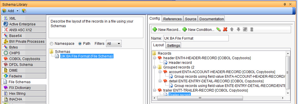

- In the Schema Library view of the Architecture School perspective, click the arrow next to Add,and then click .
- Enter a name for the schema that is based on the file type with which it is used.
- On the right side of the Schema Library view, the file schema definition is displayed on the page.
- Add records (that is, the schemas that are imported earlier that define the file records) to the file schema by clicking New Record.
- In the Schema wizard, select the wanted schema (or add one) and click Finish.

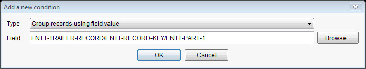

Add conditions to the defining records by clicking New Condition.
Conditions are used to help HCL OneTest™ API understand the structure of the file that is being processed. If available for a condition, you can select a field within the record to use for matching the condition.
In the example file schema that is shown, the file contains a header record, a number of group records, and a trailer (footer) record. Within each group record, one or more detail records can show.
Record definitions can be moved and deleted by using the Remove Record, Move Up, and Move Down icons. Conditions cannot be moved, but they can be deleted by using the Remove Condition icon.

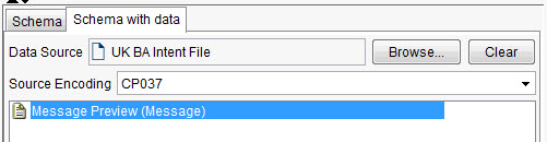

- In the Schema with data tab, click Browse to select the file resource (created in the Logical View) that defines the file to be processed.
Select the wanted encoding type to apply from the Source Encoding list.
A preview of the file to be processed is displayed.
