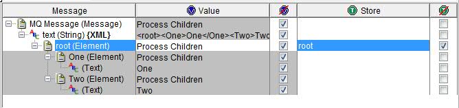

Running a test with the Validate Using Tag action
fails with The tag tag_name did not contain
a tagged message error. The following message is seen in
the test console: |
The tag is a plain string type. | To display the tag value, you should use a Log
action before the message action. It should display {} characters
as shown: root={one={="one"} two={="two"}}. See
the image for guidance: ![]() |
