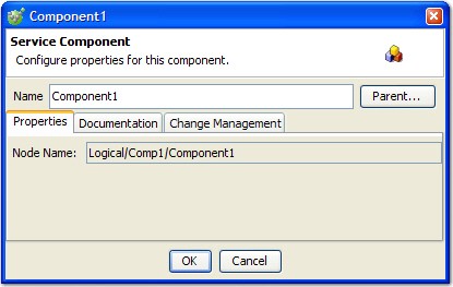

Viewing the component details
- Double-click the component or right-click
it and select Open from the menu. The component
editor is displayed.
- The component name is displayed, with more
information in various tabs, as follows:
Field Description Node Name The name of the component (see Changing a component name). Type For infrastructure components, the type of the component. Parent Click this button to change the components parent (For more information, see Changing a components parent.) Properties Resource Path The fully qualified name of the component, including its location in the project hierarchy. Bindings (Infrastructure Components only) Environment The name of the environment (one row is shown for each environment so that a binding can be configured for each one). Binding The physical resource to which the infrastructure component is bound in the corresponding environment. Documentation Description The description of the component (see Changing the description of a components). Created The date and time when the component was created, as well as the ID of the user who created it (in the By field). Updated The date and time when the component was last updated, as well as the ID of the user who made the update (in the By field). Source Change Management Override Lets users specify a different change management integration than one inherited from another resource (higher up the project resource tree) or the default integration that is specified in the Project Settings. For more information, see HCL OneTest API and change management tools. - When finished, click OK to
save any changes and close the editor. Otherwise, click
or Cancel to
close the editor without saving changes.

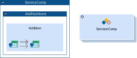

Expanding and collapsing components
You can view Service components in an expanded (default) or collapsed state.
To change the current state of a component, simply click the expand/collapse icon (in the title bar). The image illustrates the same component in its expanded and collapsed states:
