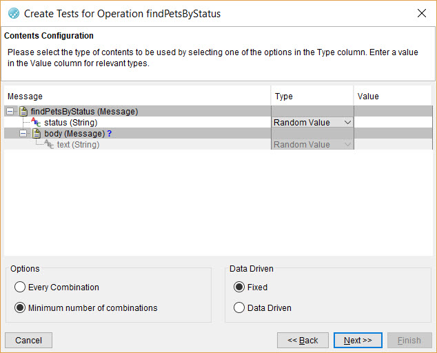

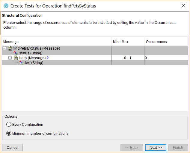

When you create Contract tests you can opt to alter the occurrences of some of the message elements in the Structural Configuration dialog or opt to change the value of the element type in the Contents Configuration dialog.
You can create different Contract tests for each of the content configuration or the variable test data that you set by selecting the Fixed option.
- A single data-driven Contract test with multiple content iterations is created along with the test data in an Excel worksheet that specifies the values for the iterations which is used at test run time.
- Multiple data-driven Contract tests with different test structures and content iterations along with the test data in different files that are used by each of the tests during test run time.

The Structural Configuration dialog is displayed.
Note: The Binding Configuration dialog is displayed, if the operation that contains the tests has a WSDL as its parent. You must select the binding properties for the message patterns. -
Perform the following actions in the Structural Configuration dialog:
Perform the following actions in the Contents Configuration dialog:

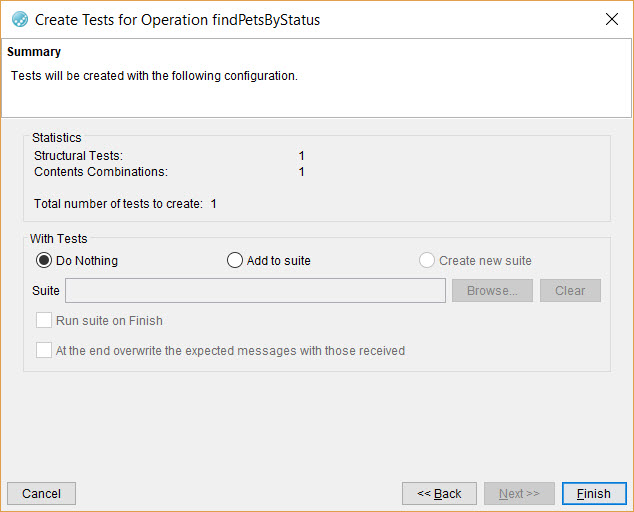

Select your action based on the options available in the With Tests panel as described in the following table:
Option Description Do Nothing Creates the Contract tests as displayed in the Statistics panel. Note: This is the default option.Add to suite Adds the generated Contract tests to an existing test suite that you select by clicking Browse, and then selecting the existing test suite. Create new suite Adds the generated Contract tests to a new test suite, which you must name in the Suite field. Note: This option is enabled only if there are more than one Contract tests to be generated. If a single Contract test is to be generated, you can only add it to an existing test suite and cannot create a new test suite.Run suite on Finish Runs the new or existing test suite when the MEP wizard closes. Note: This option is enabled if you select either the Add to suite or Create new suite option.At the end overwrite the expected messages... Overwrites the expected messages with the messages that are received when the Contract tests are run. Restriction: This option is disabled when you generate Contract tests. - Click Finish to create the Contract tests and return to the Test Factory main view.
