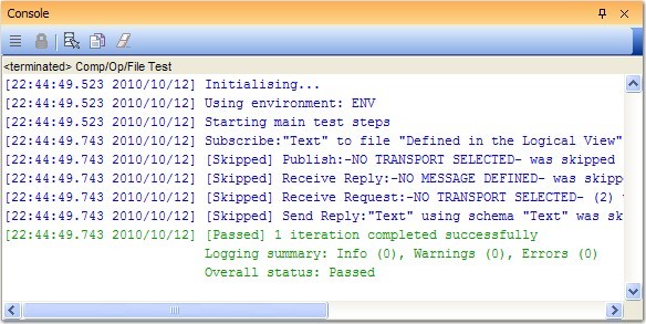

The Console
The toolbar at the top of the Console provides shortcuts for manipulating the contents of the view.
Toggle line wrapping on or off. |
Lock or unlock scrolling in the Console. |
Select all text in the Console. |
Copy the selected text to the clipboard. |
Clear the contents of the Console. |
