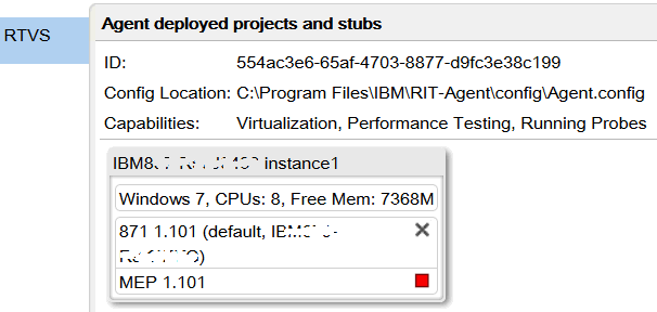

Identifying engines from logs
engine.java.util.logging.FileHandler.pattern property. Within the engine log file, INFO level messages are output with identity information:
INFO: instanceName: instance1
INFO: agentId: fb2348d5-6dec-40db-9046-44827513a44a
The instance name and agent ID can be matched to the name and ID that are shown in HCL®
Quality Server under the details for the Virtualization agent. To check to which stub and project this instance number applies, go to the Agents page and click
for the Virtualization agent:
