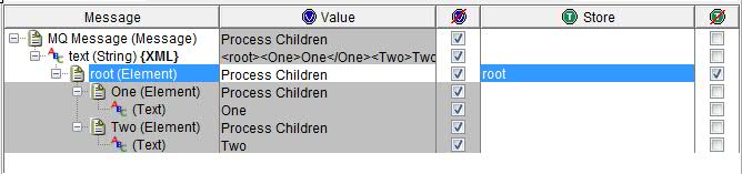

Running a test with the Validate Using Tag action fails with The tag tag_name did not contain a tagged message error. The following message is seen in the test console:
[Assertion Failed]...
The tag '%%tag_name%%' did not contain a tagged message or XML string (Action = "Validate Using Tag")
The tag is a plain string type. To display the tag value, you should use a Log action before the message action. It should display {} characters as shown: root={one={="one"} two={="two"}}. See the image for guidance:
