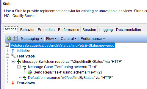

- Opened the project in the Test Factory view.
- Select the stub that you created under the operation.
Right-click the stub and in the menu, click .
The stub is displayed in the Test Editor.
The Message Switch and Message Case are created as the Test Steps with the configurations that you provided for the MEP.

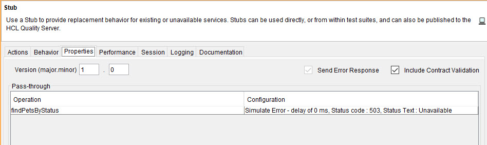

Click the Properties tab.
The Properties tab of the stub is displayed.
Select the Include Contract Validation option.
Note: When the Include Contract Validation option is selected, the following events occur:
- The Send Error Response option is automatically selected. When this option is selected, the stub is forced to send a response if the incoming message fails the validation that is set.
- The schema that is added to the messages configured for the Publish or Request MEP in the operation is automatically considered as the schema to be validated.
- Save the stub.
