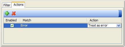

Log monitor actions
Under the Actions tab you can define specific test actions that are to be taken when a log entity matches the specified expression. When you monitor a log file during a test, you typically create actions that handle unexpected conditions (for example, errors or exceptions) in the log.
For more information about configuring log monitoring actions, see Creating and monitoring an infrastructure component.
