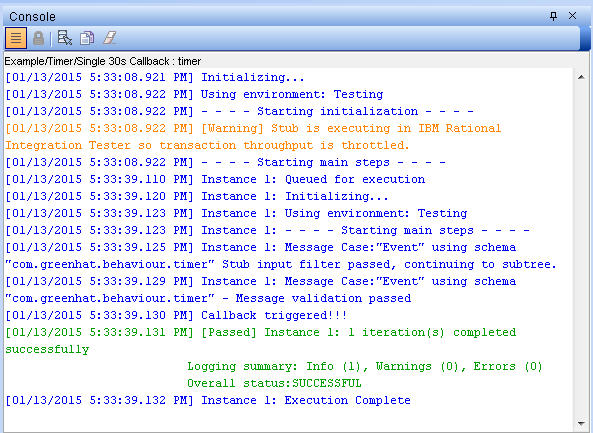

  7. Go to the Test Lab perspective and run the stub.
    In the Test Lab, you can see that the timer event was triggered after 30 seconds, at which time the output message Callback triggered!!! was sent.
    Results of running the stub with a timer

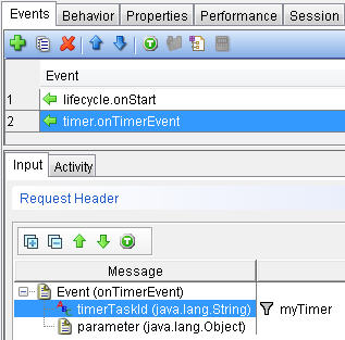

    Tip: You can use filtering to act on a stub only when a specific timer is triggered. In this example, the timer event is only triggered for the timer named myTimer. You can also tag the parameter object and reuse it in further actions.
    Stub filtering
