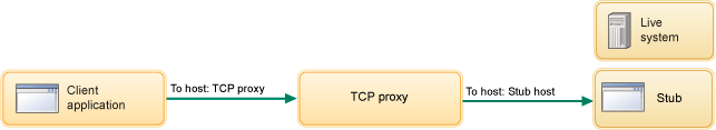

Note: Many TCP applications make a single permanent connection to the live system and send multiple messages across it. Ensure that your stub is started before the application connects to the TCP proxy. Failure to do so will result in the application making a connection to the live system and the stub will not be used.Proxy server changes the destination host to the stub again shows the system under test sending a message to the proxy host. This time a stub is running, so the proxy server reroutes the message to the stub, based on the rule that the stub created on the proxy. You can see those rules on the Network Dashboard in HCL Quality Server. For more information, see Viewing running agents.Figure 3. Proxy server changes the destination host to the stub

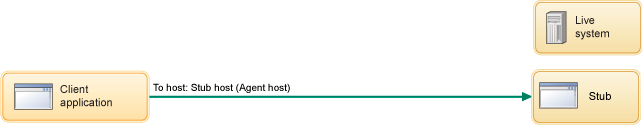

Direct connection to stub shows a direct connection from the system under test to the system that hosts the stub. No messages go to the live system; they are all addressed and sent directly to the stub. To filter the messages, use the proxy server described earlier.Figure 4. Direct connection to stub

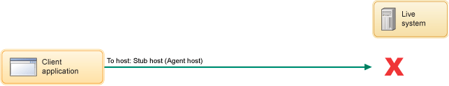

Direct connection to stub that is not running shows that the connection fails if the stub is not running, because the client connects directly to the port where it expects the stub to be running. To avoid this problem, use the proxy server described earlier.Figure 5. Direct connection to stub that is not running
