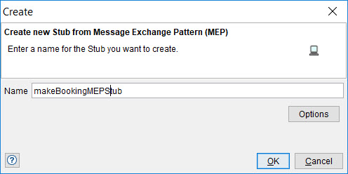

    The Create new Stub dialog box is displayed.
  3. Enter a name for the stub in the Name field.

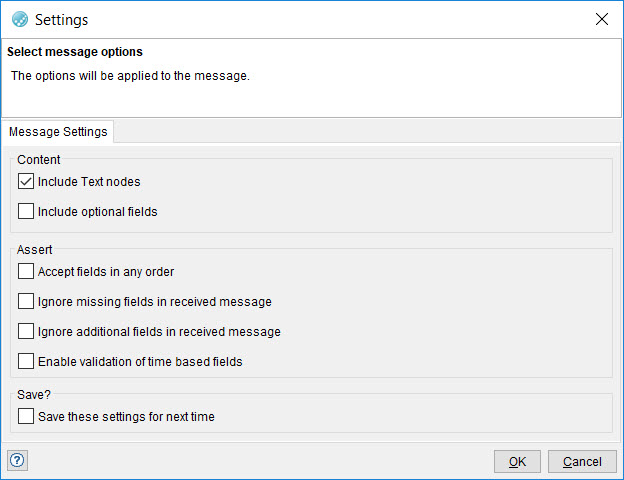

  4. Click Options to open the Select message options dialog box, and enter additional settings for messages.
  5. Click OK.
