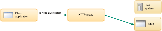

      In HTTP proxy with virtualization, the stub is running, so the request is forwarded to the stub. Depending on the configuration of the stub or the configuration of the proxy, the proxy might take one the following steps:
      • Forward all traffic for the requested host to the stub
      • Filter the traffic based on other parts of the message, such as the path of the URL or the HTTP header values
      Figure 3. HTTP proxy with virtualization
      The request goes to the proxy and then to the stub.

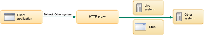

      If the system under test specifies a host other than the live system, the traffic does not match the rules that the stub has set up in the proxy. The traffic is, therefore, forwarded to the specified "other" system, as shown in HTTP proxy forwards to other system. You can see those rules on the Network Dashboard in HCL Quality Server. For more information, see Viewing running agents.
      Figure 4. HTTP proxy forwards to other system
