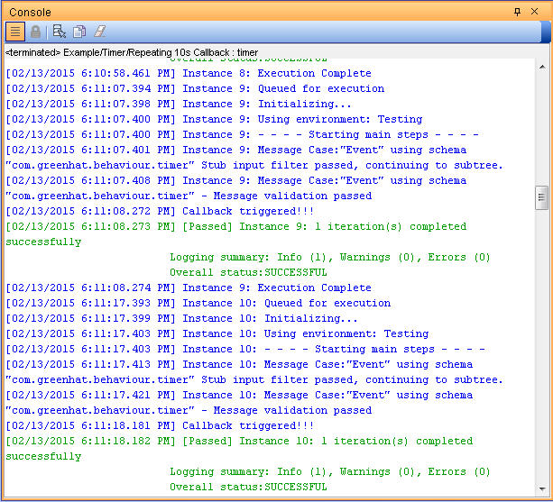

  7. Go to the Test Lab perspective and run the stub.
    In the Test Lab, you can see that the timer event repeats every 10 seconds, at which time the output message Callback triggered!!! was sent.
    Results of running the stub with a repeating timer
