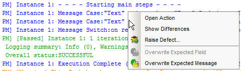

When you run a test against a stub, an entry is displayed on the stub console when a match is found. You can right click the entry for a list of options, as shown in the following illustration.
Pop-up menu options include Open Action and Show Differences.
If you click Show Differences, the Message Differences window is displayed. See The Message Differences window for stubs in this topic. For the other options, see Console options in this topic.

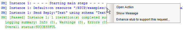

If no match is found and you have a default case (a message with a No Match guard), an entry is displayed for the default case on the stub console. You can right click the entry for a list of options, as shown in the following illustration.
menu options include Enhance stub to support this request.
If you click Show Message, the Message Differences window is displayed. See The Message Differences window for stubs in this topic. For the other options, see Console options in this topic.

Open Action Message and Default Switches to the Test Factory perspective and opens the stub for editing.
Raise Defect Message See Creating defects in the integrated change management tool.
Overwrite Expected Field Message Replaces the value of the specified field in the stub with the value from the incoming message. This option is available when the expected message differs from the incoming message in only a single field.
Overwrite Expected Message Message Replaces the model message in the stub with the incoming message.
Enhance stub to support this request Default Adds the incoming message to the Events list in the stub.
