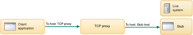

      Proxy server changes the destination host to the stub again shows the system under test sending a message to the proxy host. This time a stub is running, so the proxy server reroutes the message to the stub, based on the rule that the stub created on the proxy. You can see those rules on the Network Dashboard in HCL Quality Server. For more information, see Viewing running agents.
      Figure 3. Proxy server changes the destination host to the stub
      The proxy changes the destination host to that for the stub.
