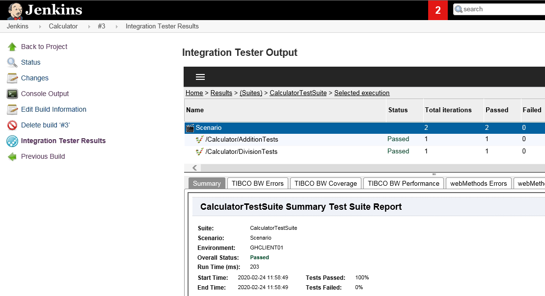

After configuring a Jenkins job to either run a test suite by using the Integration Tester Test Execution plugin or to run an Apache Ant build script generated by HCL OneTest™ API for a test suite, you can view test results within the Jenkins interface.
  1. Click Build Now by selecting the relevant job in Jenkins.
  2. Verify that the project has been rebuilt under the Build History option.
  3. Select the most recent build for the job under Build History.
  4. Click the Integration Tester Results link on the left pane.
    runtests
An output page is shown with a HCL Quality Server results page embedded. The relevant test suite results are displayed.
