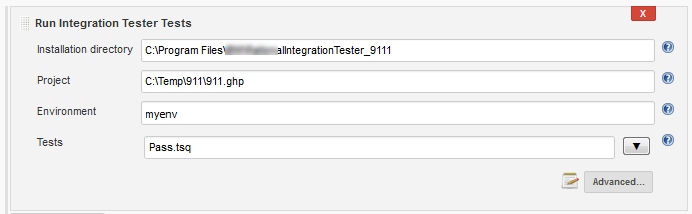

  4. Select Run Integration Tester Tests. The following dialog is displayed:
    runtests
  5. Fill in values for the task as required.
    Enter values for Installation directory, Project, Environment, and Tests. If you leave the Installation directory blank, the following environment variables are queried during runtime to find the directory:
    INTEGRATION_TESTER_AGENT_HOME and INTEGRATION_TESTER_HOME.
    The job fails if the value is blank. These variables must be visible to the user or the service account that is running the Jenkins master or slave. If you update either of the environment variables, you must restart the Jenkins master or slave for the values to take effect.
    Optionally, click Advanced to view and update the other fields. For a detailed description of any field, click the question mark icon that is next to it.
