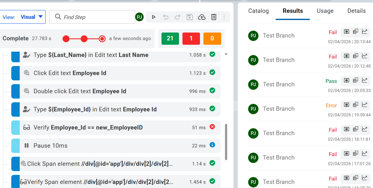

  1. Click the Run icon icon, and then select the Run on Default Cluster option to start the test for validating the recorded test for the HR management application.
    In the result summary, observe that the test is marked as 1 failed count.

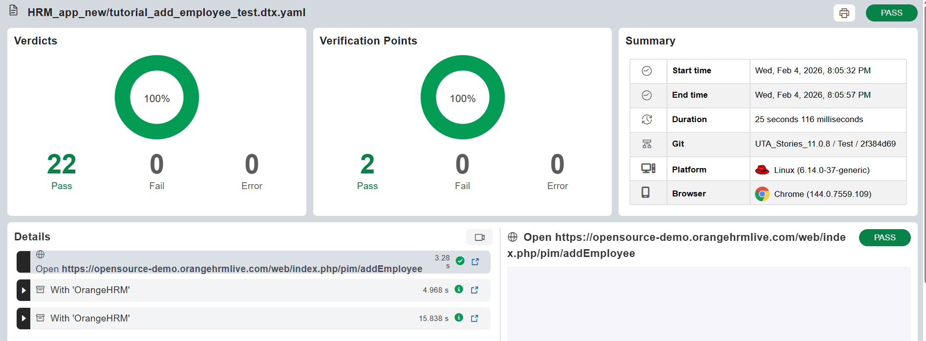

  2. Click the Functional Report icon to open the report in a separate window.
  3. Click the Expand icon in the Functional Report to view detailed results.
    You can now see the failed step and identify the reason for failure.
  4. Click the Open in new tab icon to access the specific test in the Test Editor page, where you can review and edit the test steps.
    Review the failed step.
    The Employee_ID step failed because the value of Employee_Id is defined as new_Employee_Id in the Verify step.
  5. In the Verification Points, select the correct variable value (Employee_Id) from the drop-down list.

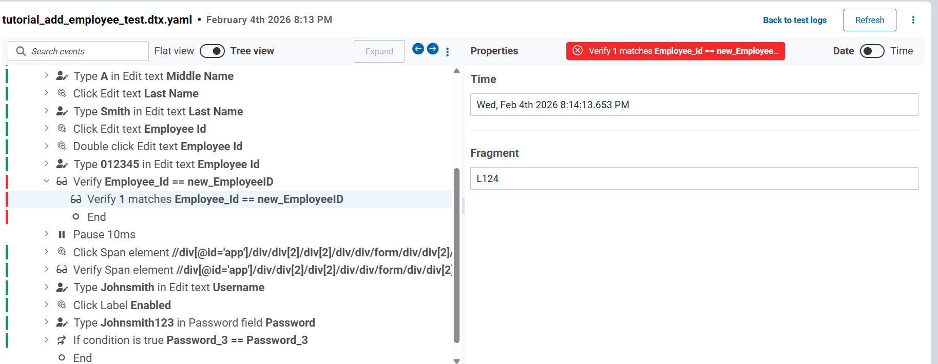

  6. Click the Test Log icon to open the Test Log Report to view the step-by-step details of each test step while running the test.
  7. Click Save to update the test.
  8. Click Run icon icon, and then select the Run on Default Cluster option to run the test again.
    • The test completes with 0 failed count
    • The test status shows Pass in the Results tab
    • The Functional Report shows 100% Pass
