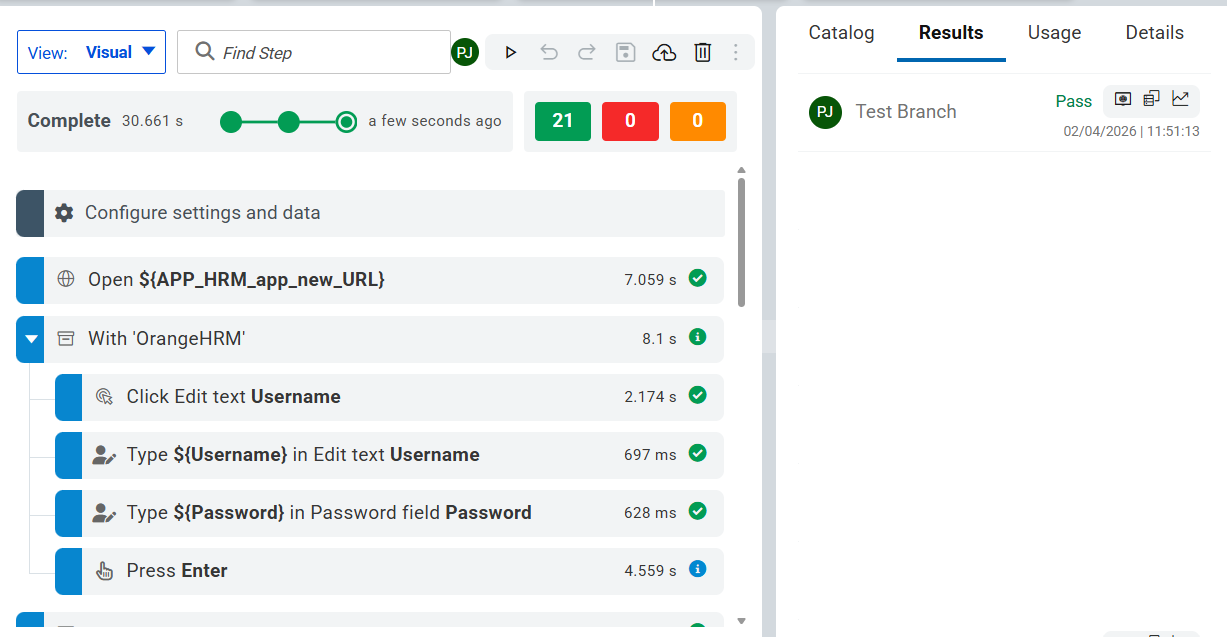

  1. Click the Run icon icon, and then select the Run on Default Cluster option to start the test run for validating the recorded test for the HR management application.
    When the test run starts, the Catalog tab automatically switches to the Results tab so that you can monitor the execution status.
  2. Observe the following stages during the test run on the Test Editor page:
    • In transition: The test setup is in progress.
    • Running: The test run is active.
    • Complete: The test run is completed. This section also displays the time taken for the test run.
    • The passed count, failed count, and error count are displayed on the Test Editor page.

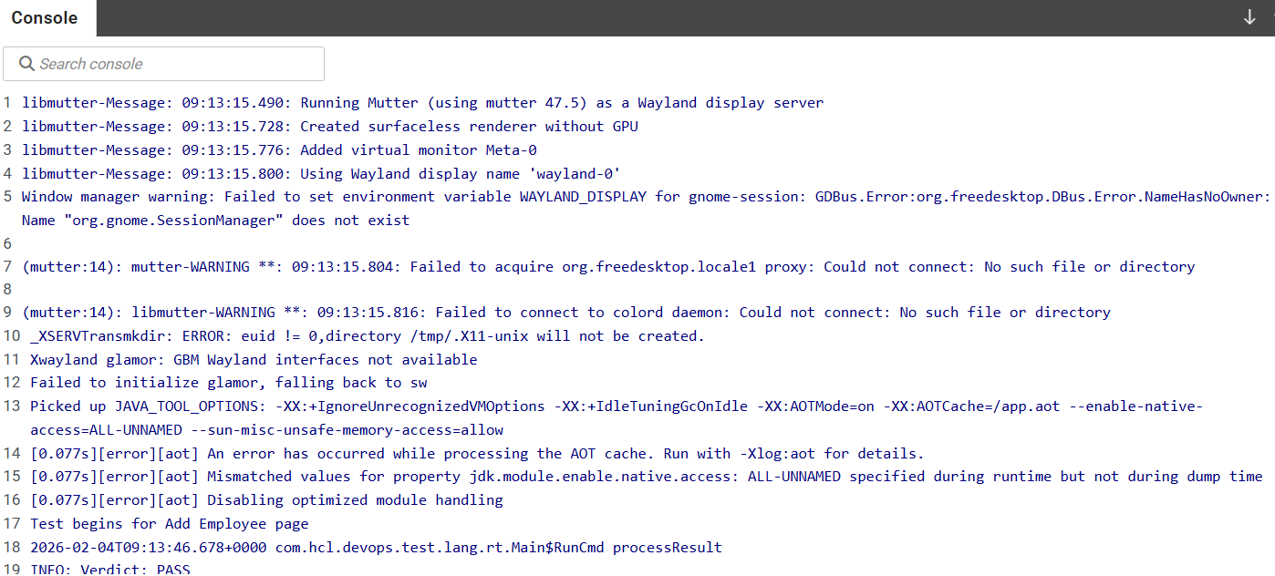

  3. Click the Console tab to view information such as error messages, logs, and the test verdict.
    You can then use this output to troubleshoot issues by reviewing details, such as session IDs and error messages.
