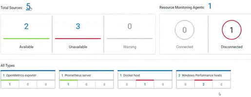

  1. Click a source that is available in your project, either in the Total Sources cards or in the All Types cards from the resource monitoring page.
    View of total and type of sources and agents

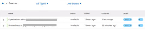

  2. Click Plus sign you must click to add a label under the Labels column of a resource monitoring source to add a label.
    List of added sources
  3. Enter a name for the label and press the Enter key.
    Example: Enter 'SUTv2' in three different resource monitoring sources.
    You can add one label or multiple labels for the same resource monitoring source. A label can contain a maximum of 200 characters.

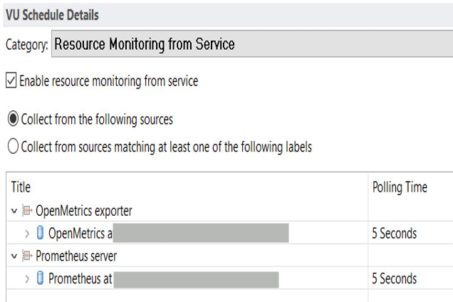

    • If the Resource Monitoring from Service option was enabled in Test Performance, and data is collected from the sources you added to the performance schedule in Test Performance (see Figure 2), the Resource Monitoring tab displays the list of these sources that are available in your Test Hub project.
      Figure 2:
      To override the initial sources with the sources that you created in Test Hub, select the labels that are in your Test Hub project and that match the Server sources (step 6 in this procedure).

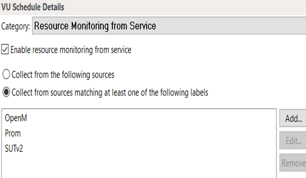

    • If you added sources to your performance schedule by using labels in Test Performance (see Figure 3), the Resource Monitoring tab displays the list of labels that are available in your Test Hub project.
      Figure 3:
      To select resource monitoring labels from your schedule, follow step 6 in this procedure.

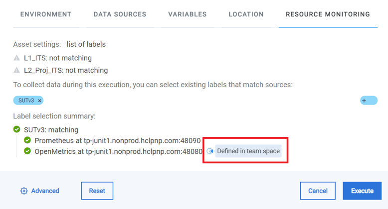

  6. Click the Plus sign you must click to add a label, and press the Ctrl + Space keys, or enter the initial letter of a label to select a label in the list.
    Example: Select SUTv3.
    Resource Monitoring tab where you select labels that are matching the sources
    You can see all the labels that you added to the resource monitoring sources in Test Hub.
    You can select labels matching resource monitoring sources that are created in a team space in addition to the ones that are created in a project.
  7. Select the labels that match the sources.

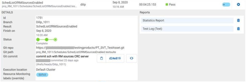

  9. Click the Result view in the navigation bar of Test Hub when the schedule is complete.
  10. Expand the performance schedule result to see the resource monitoring label name in the Details card.
    The Details card displays the resource monitoring labels that are used in the schedule to override the initial labels and collect resource monitoring sources (in the example, the 'SUTv3' label). For other details about the Results page, see the link at the end of this page.
    Example of result details and reports

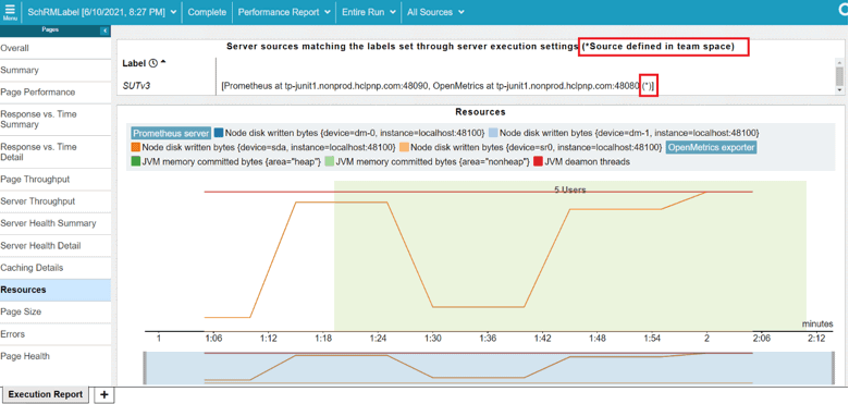

    In the Report card, you find the link to the Statistics Report that is generated. In the Resource tab of the Statistics Report, you can view the information related to the Server sources matching the labels set in the schedule.
  11. Click the Statistics Report link in the Reports card to see the performance metrics of the monitoring sources matching the selected labels.
    Example of Statistics report with Resource Monitoring matching selected labels
    Example: You can see the statistics for the sources tagged with the 'SUTv3' label.
    In the Resources report, each resource name followed by an asterisk identifies a resource monitoring source that is defined in a team space.
