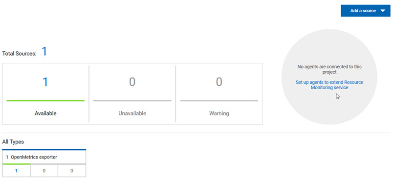

  1. Click Set up Agents to extend Resource Monitoring service link in Test Hub to access the agents page where you can find the instructions and commands that are to be used to install and run the agents.
    Link to instructions about how to extend RM service with agents
    instructions about how to configure a Docker agent

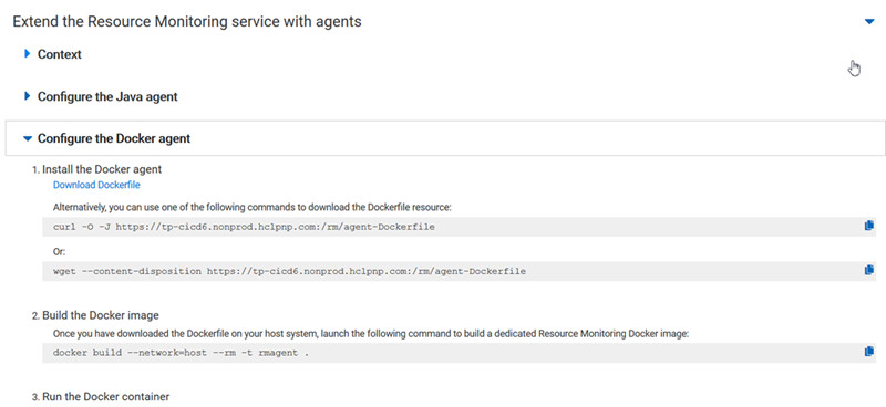

  2. Expand Configure the Docker agent and click Download Dockerfile to download a Docker agent.
    You can also use the curl or wget commands to download the agent without accessing the resource monitoring web UI.
    For more facility, use the code snippets to copy and fill in the commands with the valid offline token and the Docker file name.
    For Windows:
    curl -O -J https://hostName/rm/agent-Dockerfile
    For Linux:
    wget --content-disposition hostName/rm/agent-Dockerfile
  3. Copy the build command that is under Build the Docker image, paste it in your console and run it to build a resource monitoring Docker image.
    Before you start the a Docker agent, you must build a Docker image.
    docker build --network=host --rm -t rmagent

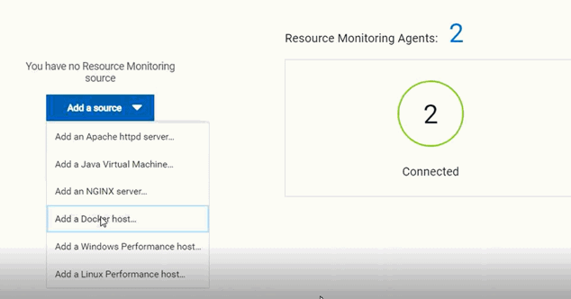

When the agent is started, the agent is connected to Test Hub. The agent is displayed in the list of connected resource monitoring agents with the hostname and status of the agent. The agent is also added to the main page of the resource monitoring service in Test Hub.
What to do next
You can add a new resource monitoring source. It can be collected from a service or from the named agents, depending on the capabilities supported by the environment.
