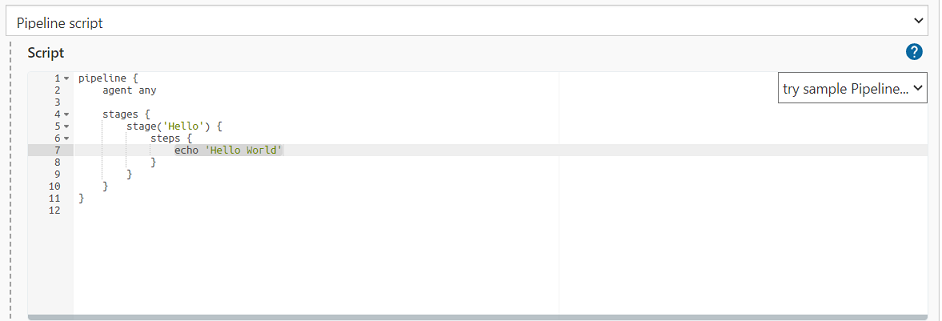

    For example, if you select Hello Word from the drop-down list, then the sample script is displayed as follows:
    pipeline_sample_script

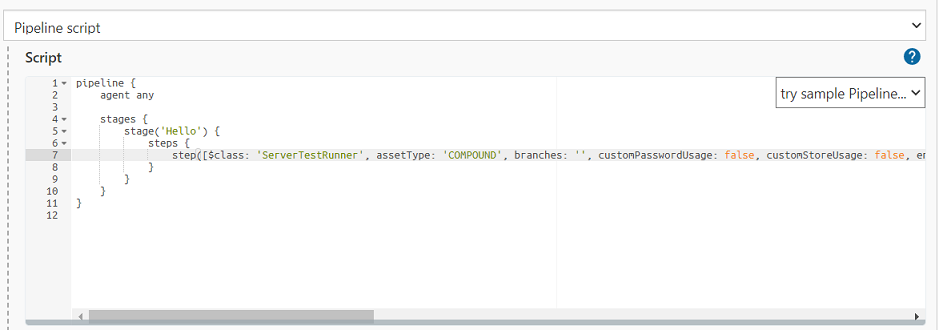

  5. Specify the script that you created in place of echo ‘Hello Word’.
    pipeline_script_edited
    You can provide a different name for the stage in the script.
