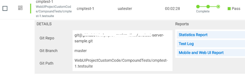

  1. Go to the Results page and identify the test that you ran.
  2. Click the test so that the Reports panel is displayed.
  3. Click the Test Log in the Reports panel.
    The Test Log is displayed in a browser window.
