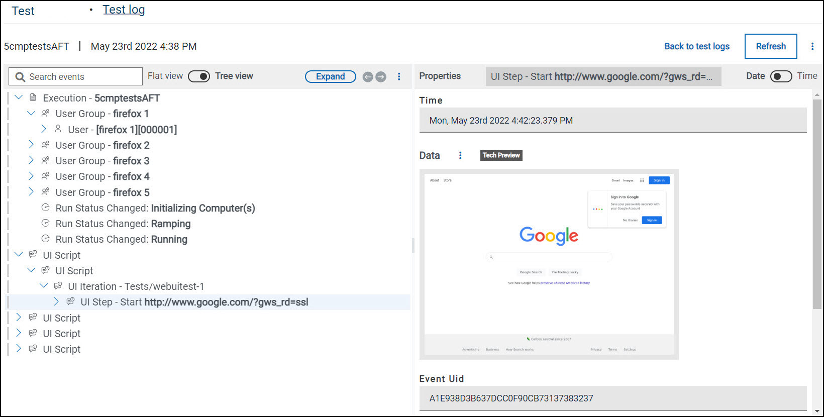

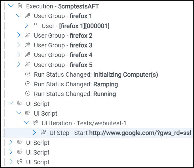

The activities and events captured in the test log are displayed in the Tree view in the Test log panel. An example of the log in the tree view that is displayed is as follows:
Image of the tree view of the test log.

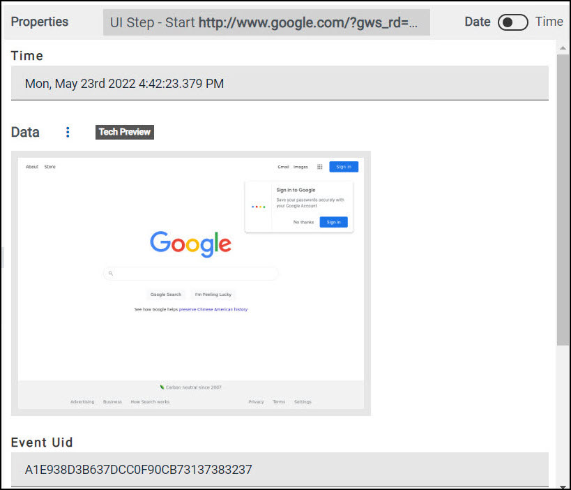

An event in the test log. Details of the event is displayed in the Properties panel. An example of the details that is displayed in the Properties panel is as follows:
Image of the properties panel.

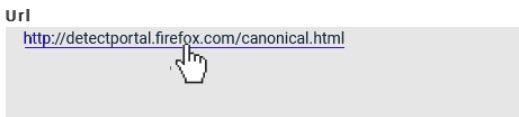

The link to a URL that is recorded in an event. The URL is displayed as a link. When you click this link, the specific URL opens in a web browser.
An example of a link recorded in the event.
Image of the URL link in an event.

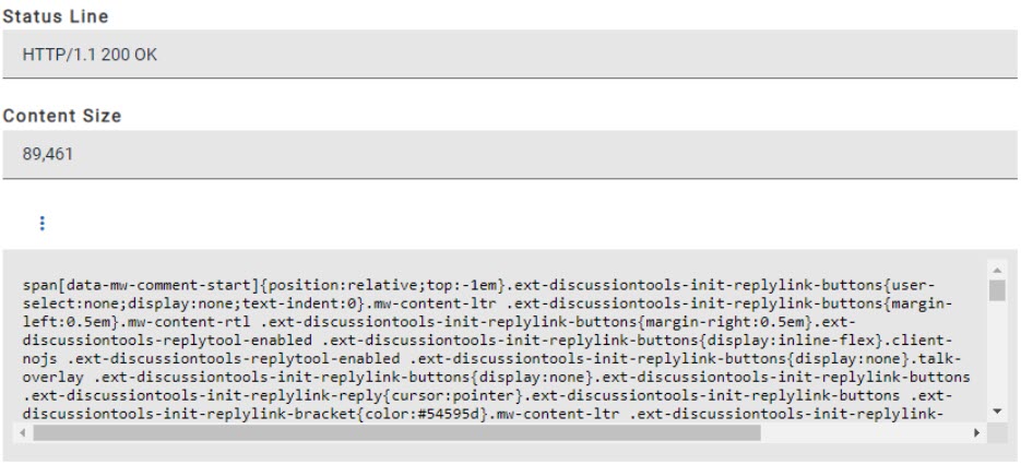

An attachment of an event in the test log. The details of the attachment is displayed in the Properties panel. An example of a text extracted from the attachment.
Image of the text contents in the properties panel

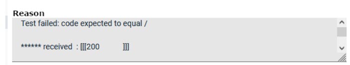

The reason of a Verification Point (VP) that is captured in an event in the test log is displayed in the Properties panel. An example of the reason in a VP that is displayed in the Properties panel is as follows:
Image of the reason contents of a verification point in the properties panel

Expanding the display of events in the test log panel.
Click Image of the toggle button icon. to expand the events that are contained within the event selected in the test log panel.

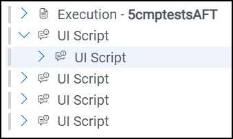

For example, the collapsed view in the test log panel can be as follows:Image of the collapsed events view in the test log panel.

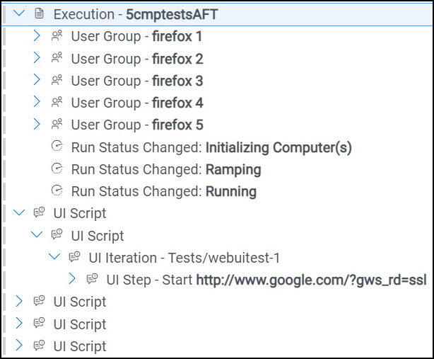

When the event is expanded, the view in the test log panel can be as follows:Image of the expanded events view in the test log panel.
Collapsing the display of events in the test log panel.
Click Image of the toggle button icon. to collapse the events that are contained within the event selected in the test log panel.

When you select an even in the test log panel, its properties are displayed in the properties panel.
For example, the details that are displayed for an event can be as follows:
You can view the following information:
  • The variable in the event is displayed.
  • The date stamp showing the time at which the event was captured in the test log.
    You can toggle between the calendar time and the duration from the time the test started its run in the cluster by clicking the Date and Time toggle icon Image of the toggle button icon.. In the example, the date that is displayed in the Time field is as follows:
    Image of the date displayed.

  • Data that was captured as part of the test step. The items that are captured can be images, text files, PDF files, XML files, JSON files, and other supported formats.
    You can view the attachment that is in the Data field, if it is supported to be viewed in a web browser by clicking the attachment. The attachment displays in a browser tab other than the one in which the Test log page is displayed.
    You can also copy the URL of the attachment or download a copy to your computer to use the attachment elsewhere.
