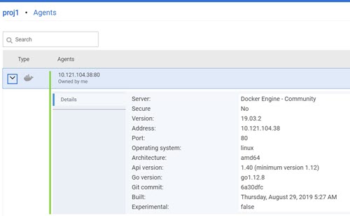

Note: You can add the Docker hosts that you registered. You can add any number of Docker hosts to your project.The Docker hosts that you added to the project are displayed.You can view the details of the Docker host by clicking the Expand icon
