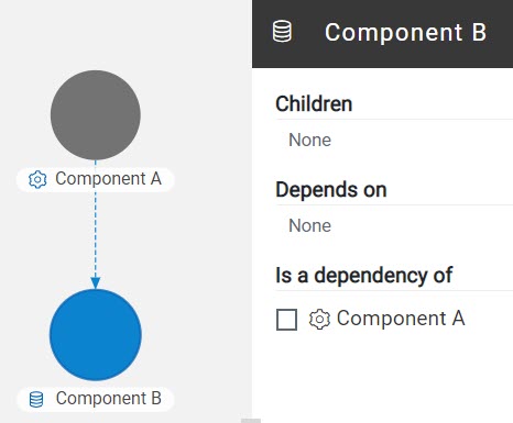

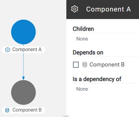

You can define the relationship between components if one component depends on another or if a component has a dependency of another component. The Depends on or Is a dependency of relationship depends on the component that you select in the system model after you define the relation.
For example, if you define Component A to depends on Component B, then the relationship is displayed with a line arrow from Component A to Component B, and the arrow points to Component B.
