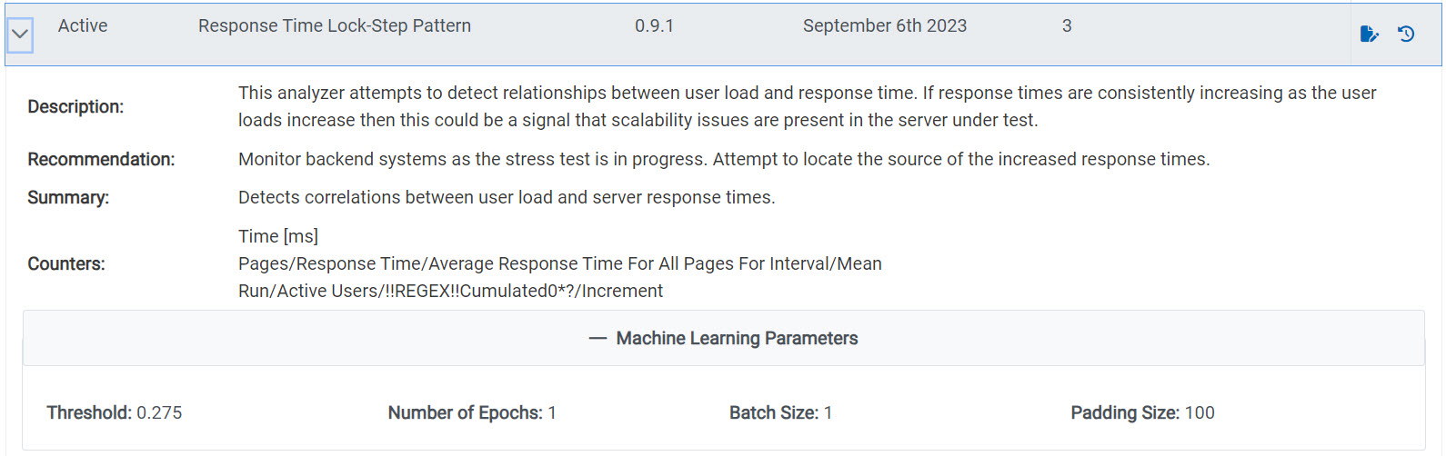

The Response Time Lock-Step Pattern parameter analyzer
- The description of how the ML analyzer has attempted to analyze the parameter in the test.
- The methods to control the problems are provided as a recommendation.
- The summary of the analysis.
- The counters used in the analysis.
- The parameters used in the analysis.

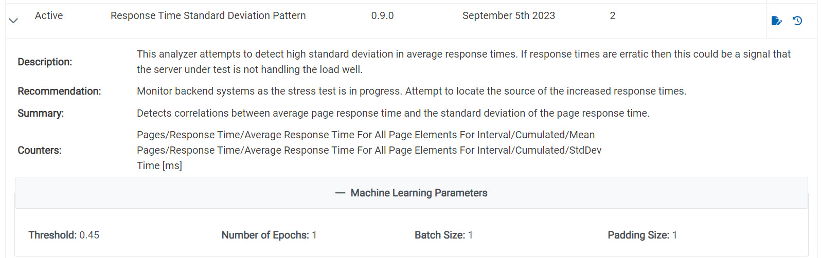

The Response Time Standard Deviation Pattern parameter analyzer

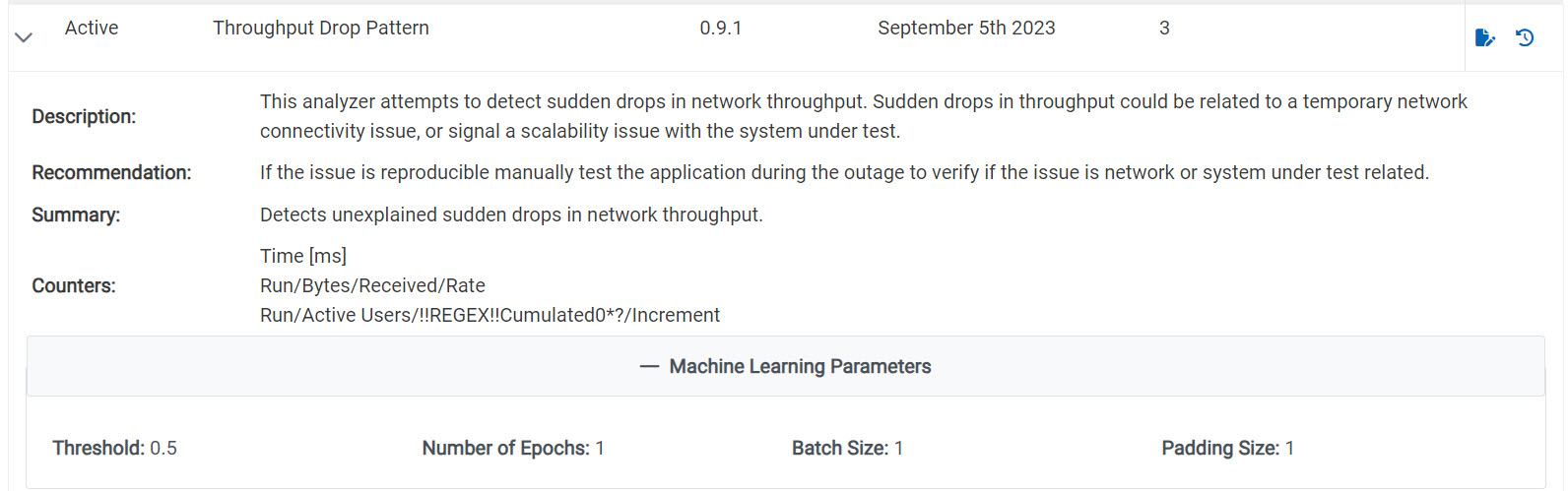

The Throughput Drop Pattern parameter analyzer

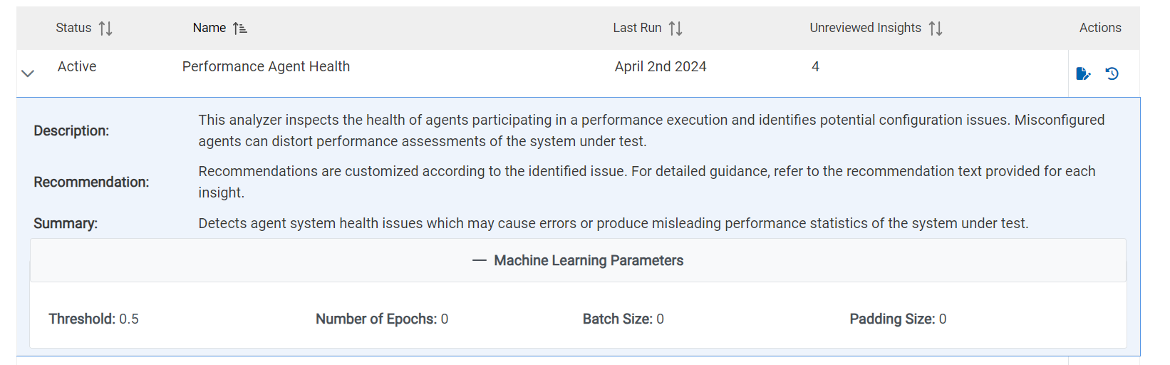

The Performance Agent Health parameter analyzer
