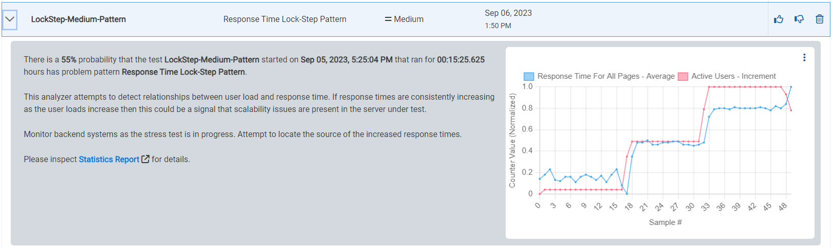

Insights on the Response Time Lock-Step Pattern parameter
When you expand the insight about the Response Time Lock-Step Pattern parameter, you can view the
details displayed similar to the following sample:
The following information is displayed as insights into the test on analyzing the
Response Time Lock-Step Pattern parameter:
- The probability of finding a problem in the test.
- The description of how the ML analyzer has attempted to analyze the parameter in the test.
- The methods to control the problems are provided as suggestions.
- The graph of the observed data points.
- The link to the Statistics Report generated for the test.

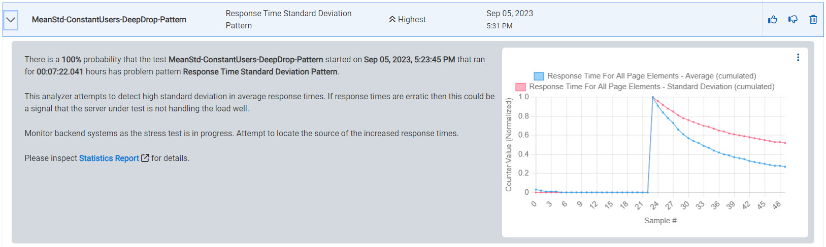

Insights on the Response Time Standard Deviation Pattern parameter
When you expand the insight about the Response Time Standard Deviation
Pattern parameter:

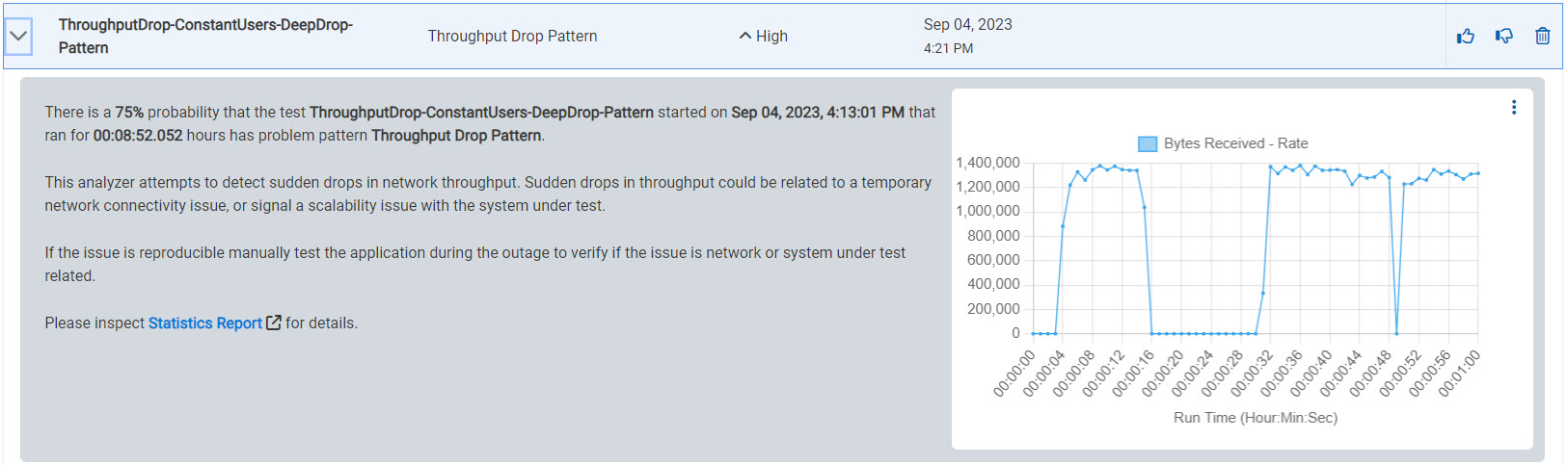

Insights on the Throughput Drop Pattern parameter
When you expand the insight about the Throughput Drop Pattern parameter, you can view the
Throughput Drop Pattern parameter:

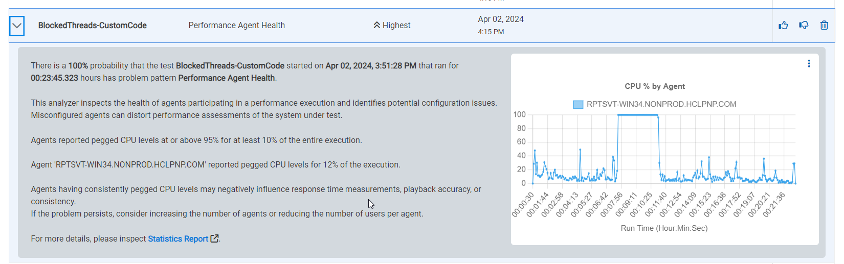

Insights on the Performance Agent Health parameter
When you expand the insight about the Performance Agent Health parameter, you can view the
Performance Agent Health parameter:
