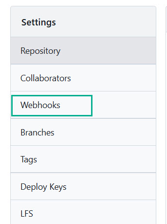

  1. Navigate to your Control repository in Gitea and click Settings.
  2. In the left navigation panel, click Webhooks under Settings.

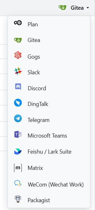

  3. Click Add Webhook and select Gitea from the drop-down list.
