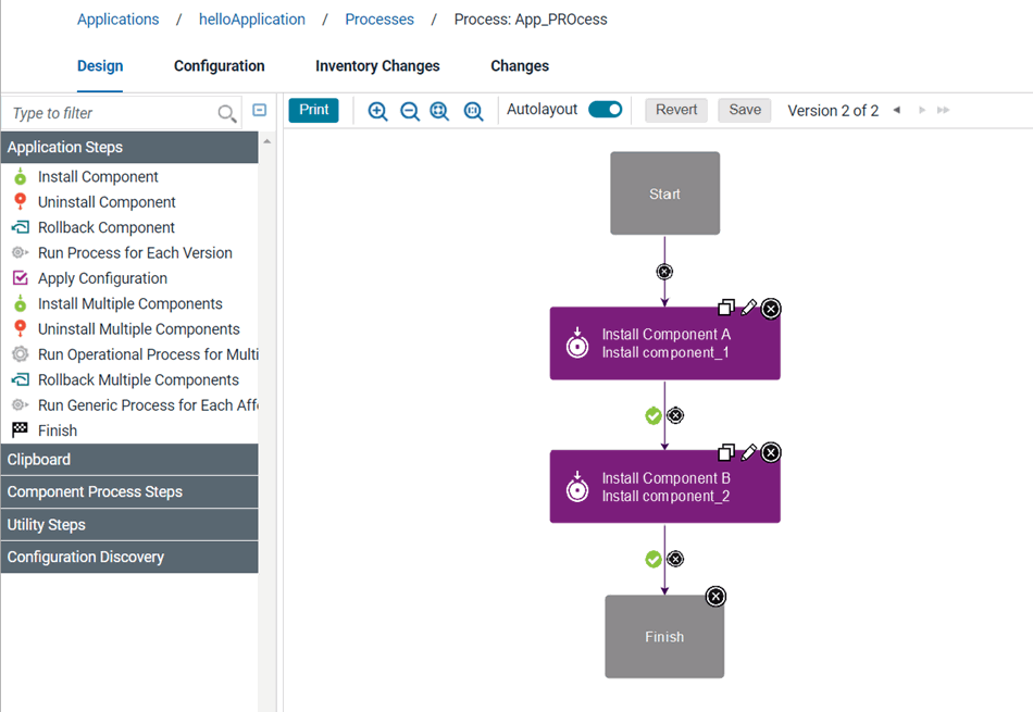

Example
The following example application process deploys two components. The Install Component A and Install Component B steps call the deployment processes for each component.
An example application process that uses the Install Component step twice to deploy two components
