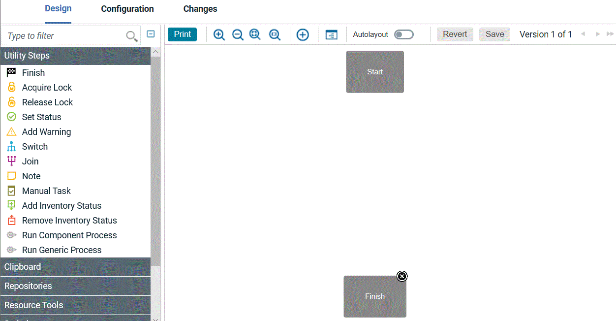

  2. Open the helloProcess process editor and go to Design.
    The process editor lists plug-ins and steps. The required Start and Finish steps represent the beginning and the end of the process and are automatically placed on the design area. You add steps to the process by dragging them onto the design area and arranging them between the Start and Finish steps.
    The process design editor

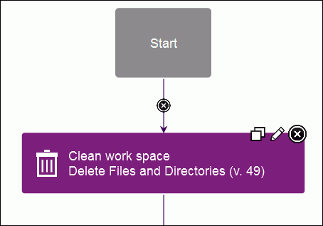

    The new step is displayed in the design area. Each step has two icons at the upper-right corner of the step. Click the Edit icon to reopen the Edit Properties window where you can modify the step properties. Click the X icon to delete the step and connections to or from it.
    The new process with one step
    The Start and Finish steps are automatically connected to the step.
  4. Optional: If the process step became disconnected from the Start and Finish steps, connect the Start step to the Clean work space step. Beginning with Start, the connections between steps determine the process flow. You can define connections as you place steps or later.

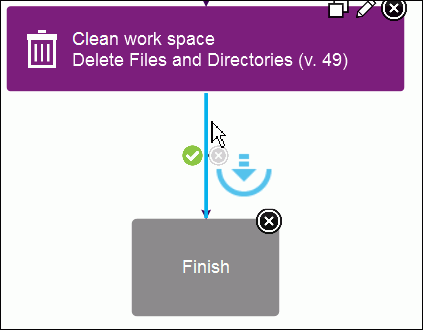

    1. Click Repositories, and under Artifact/Deploy drag the Download Artifacts step to the process editor.
      Be sure to highlight the connection arrow when you drag the step to the process editor so that connection arrows are automatically inserted from the previous step to the Finish step. See the highlighted connection arrow in this illustration: Highlighted connection arrow as a step is dragged to the process editor
    2. Click the Edit icon , and in the Edit Properties window, accept the default values; then, click OK.
    3. Optional: If you didn't highlight the connection arrow when you dragged the step to the editor, complete these steps:
      1. Delete the connection arrow between the Clean work space step and the Finish step.
      2. Draw a connection from the Clean work space step to the Download Artifacts step, and then connect the Download Artifacts step to the Finish step.
      Tip:
      To manually connect steps, move the mouse over one step. The arrow icon is displayed, as the following figure shows. You use this icon to connect steps to one another.
      The arrow icon
      . Click and drag the arrow icon over the subsequent step. The direction of the arrow defines the direction of the process flow.
      Except for connections from Start, each connection has a conditional flag. The conditional flag represents the process status that is required before the connection can be followed. The connection is followed only if the originating step is complete, and the specified condition is met. The possible conditions are as follows: success, failure, or either. The default condition is success, which is represented by a green check mark, as the following figure shows. In this example, the Download Artifacts step is started only if the Clean work space step finishes with a success condition. You can change the conditional flag by clicking the icon.

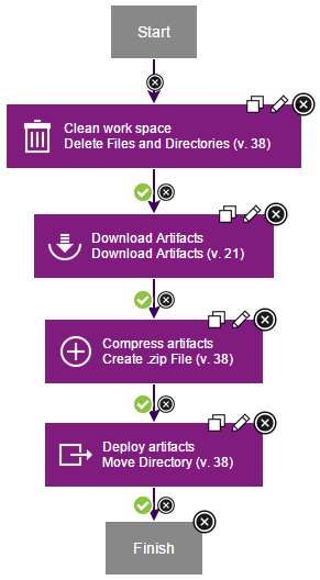

The complete process for the helloWorld component looks like the following figure:
In this lesson, you created a component process to deploy the helloWorld component.
