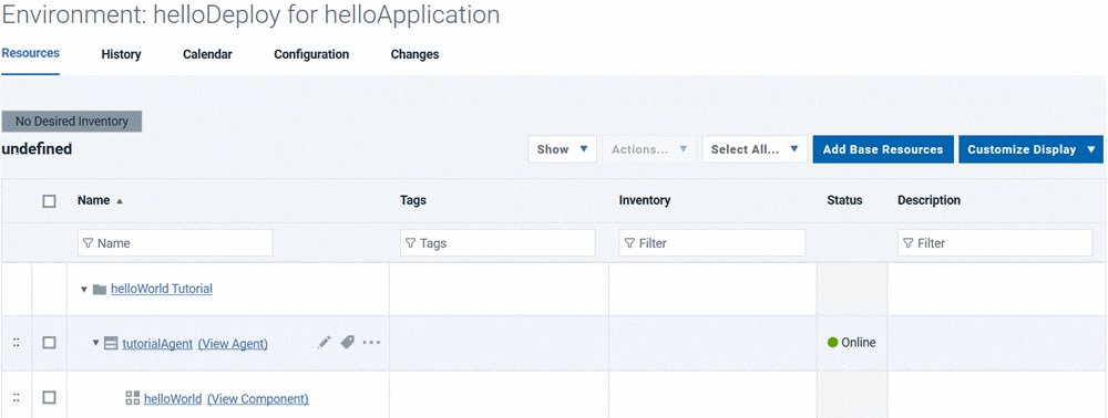

    1. Click the check box for the helloWorld component.
    2. On the same row as the Add Base Resources push button, click Actions > Add Tag.
      The Add Tag selection is shown in the following figure:
      The Actions > Add Tag command

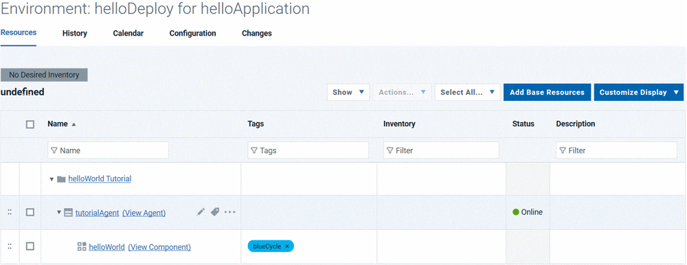

    3. In the Add New Tag window, type something like blueCycle in the Name field, select a color for the tag, and then click Save.
      While you can select any color, blue is a good choice. Applications can be configured to use resources with a specific tag. For example, a continually running environment might take one group of blueCycle tagged servers offline to update them, then put them back online and take another differently tagged group offline. You can also configure a process to deploy all components with a particular tag.
      The finished resource with the blueCycle tag is shown in the following figure:
