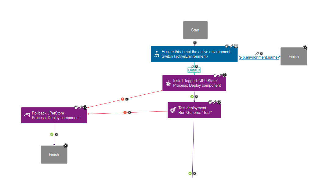

  2. On the process designer, add a Switch step that tests the activeEnvironment property.
    There are several ways to ensure that the process is running on the correct environment, but this method easy to implement. The Switch step compares the activeEnvironment property to the name of the environment on which the process is running. If those names match, that means the process is running on the active environment, which is not what you want and the process ends.
    If the activeEnvironment property is not on the Property Name list, review the previous lesson in Creating the environments.

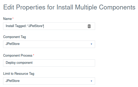

  3. Add an Install Multiple Components step.
    This step uses the JPetStore tag to deploy the JPetStore components. This step iterates over each component with the specified tag. If you use your own application, ensure that the component processes all have the same name. The components are deployed to the green-a and green-b resources in the currently inactive Green system.
    Deploy multiple components step
  4. Optional: Add the optional automated testing step.
    If you typically run tests on your deployments, this is a good place to add them. For simplicity, you might use a Shell step or a generic process to as a placeholder for processing flow.
  5. Add a Rollback Multiple Components step.
    If either the deployment step or the automated test fails, the process rolls back the newly deployed components to the version that was deployed at the beginning of this application process. As with the previous step, you might use a manual step or run a generic process step to represent the rollback feature.

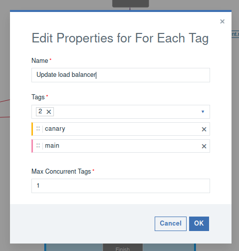

  6. Add a For Each Tag utility step to the For Each Tag loop.
    By the time processing gets to this loop, the new version of the application is already deployed to the inactive environment. The purpose of this loop is to update the load balancer in stages. In the loop, the Canary tag runs first, followed by the Main tag. This works because the For Each Tag step lets you restrict processing to specific tags and control the order in which they are processed. When the Max Concurrent Tags property is set to 1, only one node is processed at a time. In this case, the Canary-tagged node is processed before the other nodes.

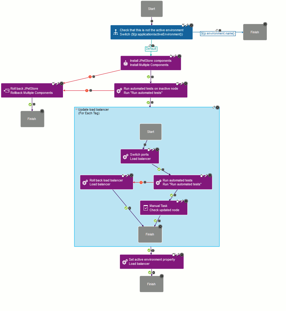

  10. Add a manual task step that you can use to verify the updated.
    The manual approval lets you verify that the canary node is working properly before the loop runs again and updates the other nodes. Your approval process is probably different, but the manual approval lets you verify that the deployment is running the way you expect for this example tutorial.
  11. Click the new process to open it in the process editor.
    At the end of the process, the process updates the active environment property with the name of the newly active environment. I'm using a component process on the load balancer component for this, but there are other ways to change the application property.
    The complete process
