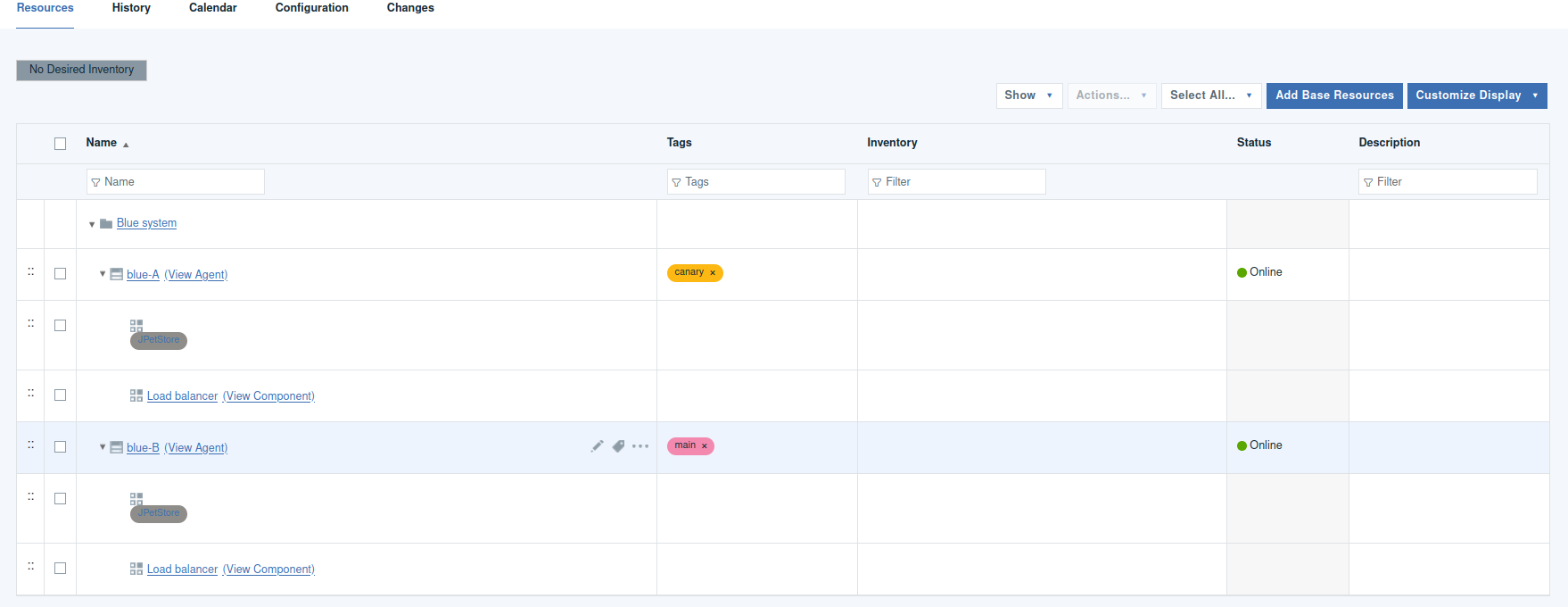

  5. Add theBlue system agent resource to the Blue environment.
    Because you put the JPetStore component tag on the resource, you don't have to map the individual components. The component tag grabs all of the components at once.
    The resource is shown on the Resources tab for the environment, as shown in the following figure:
    The Resources tab for the environment, which shows the resource that is bound to the environment
