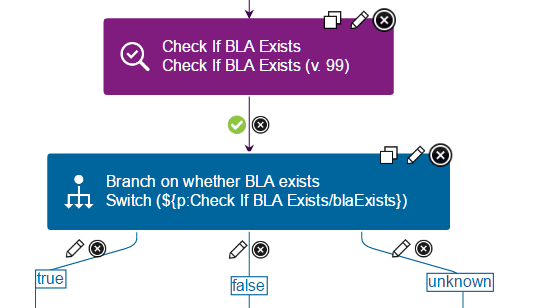

Then, you can refer to these output properties in other steps in a process. To do so, you must know the name of the step that contains the output property that you use. For example, your process might require different actions if a BLA exists. In this case, you could use a Switch step to branch the process for each case. In the following figure, the Switch step checks the value o f the blaExists output property by using the code ${p:Check If BLA Exists/blaExists}:
Using an output property value as the input for a Swtich step
