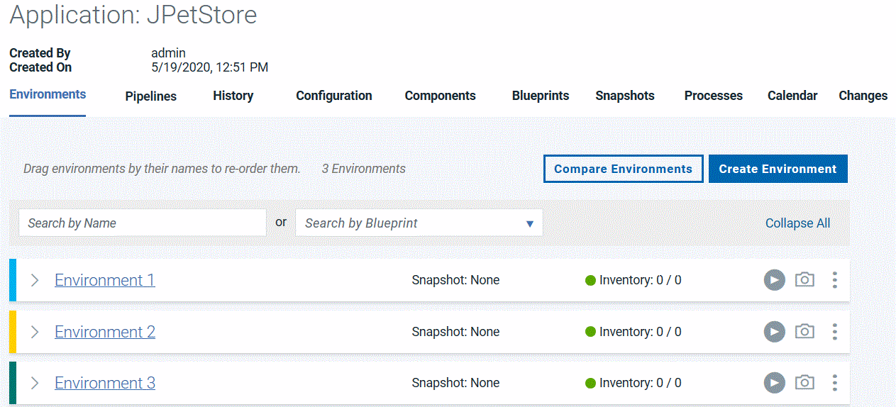

- In the web UI, click the Application tab.
- Click the name of the application.
The application environments are displayed.
For the environment to run the deployment in, click Request Process

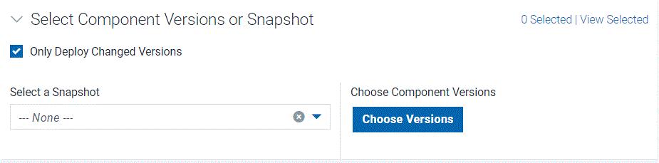

Specify component versions or snapshot to deploy.

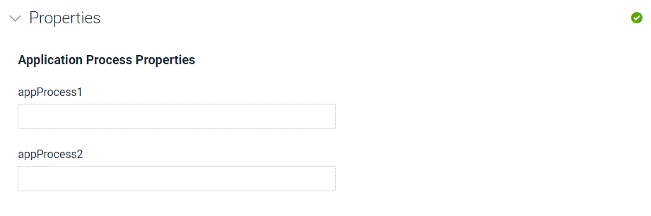

Expand the Properties area and specify application properties for the deployment, if any.

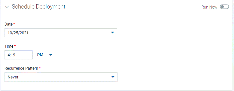

Schedule the deployment for a later date by disabling Run Now and then
specify the date, time, and recurrence pattern of the deployment.

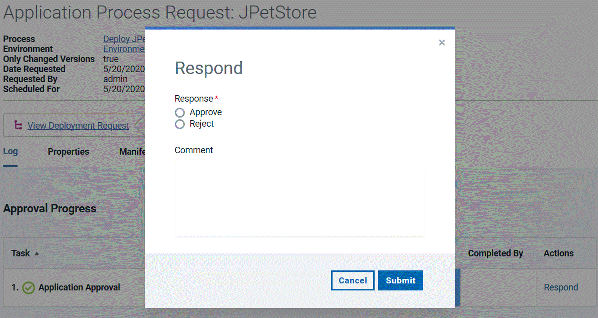

When a process starts, use the Application Process Request pane to review the deployment status. This pane is also used if the process requires approvals, as shown in the following figure.
