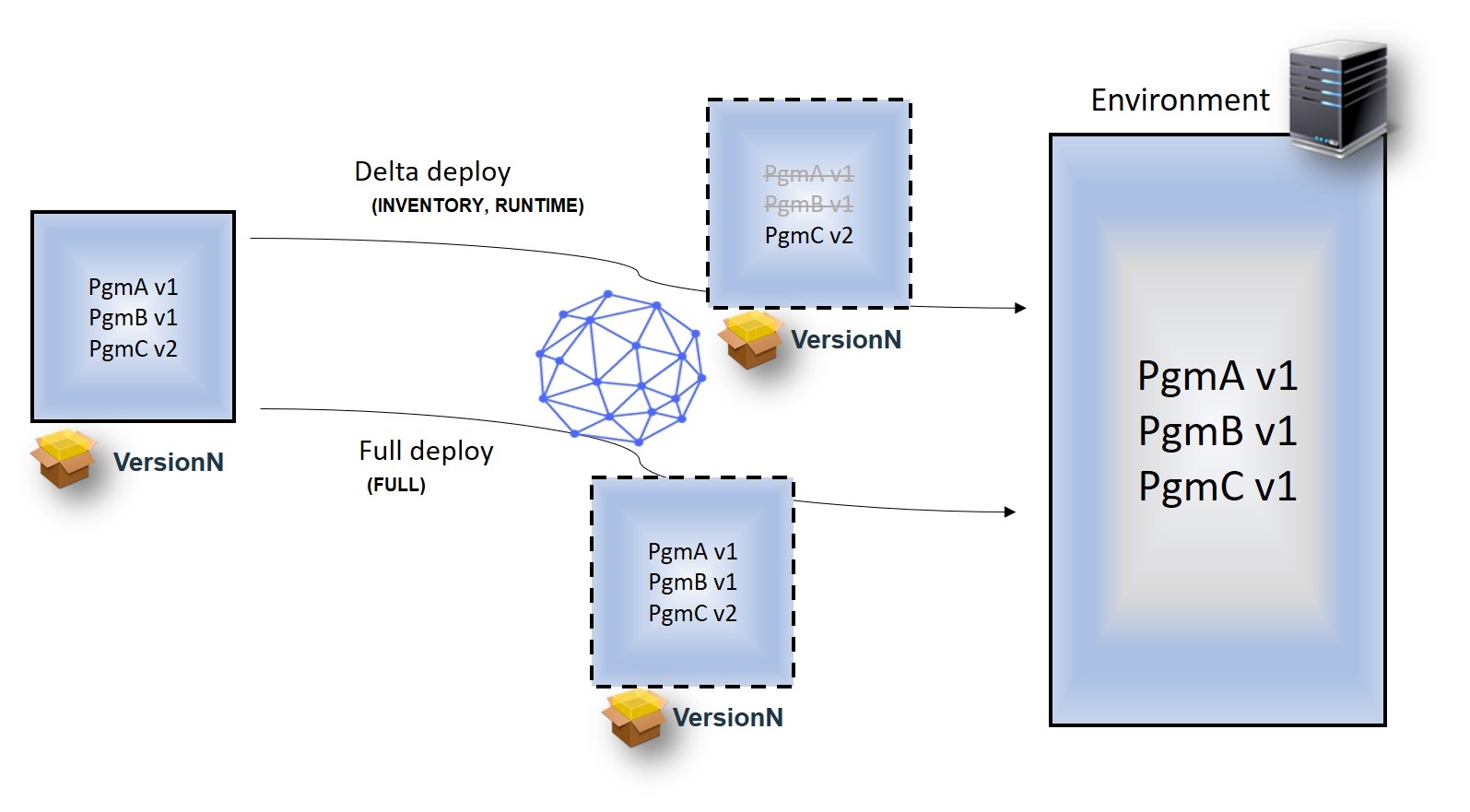

A FULL deployment type replaces all artifacts with artifacts in the current component version.
An INVENTORY deployment type, or delta deployment, reduces deployment time significantly by deploying only the changes between artifacts.
A RUNTIME deployment type is a delta deployment that uses checksum logic to compare artifacts to be deployed with the same artifacts in the target environment. This check is done for every artifact. Only artifacts with checksums that don't match are considered as changed and used for deployment.
