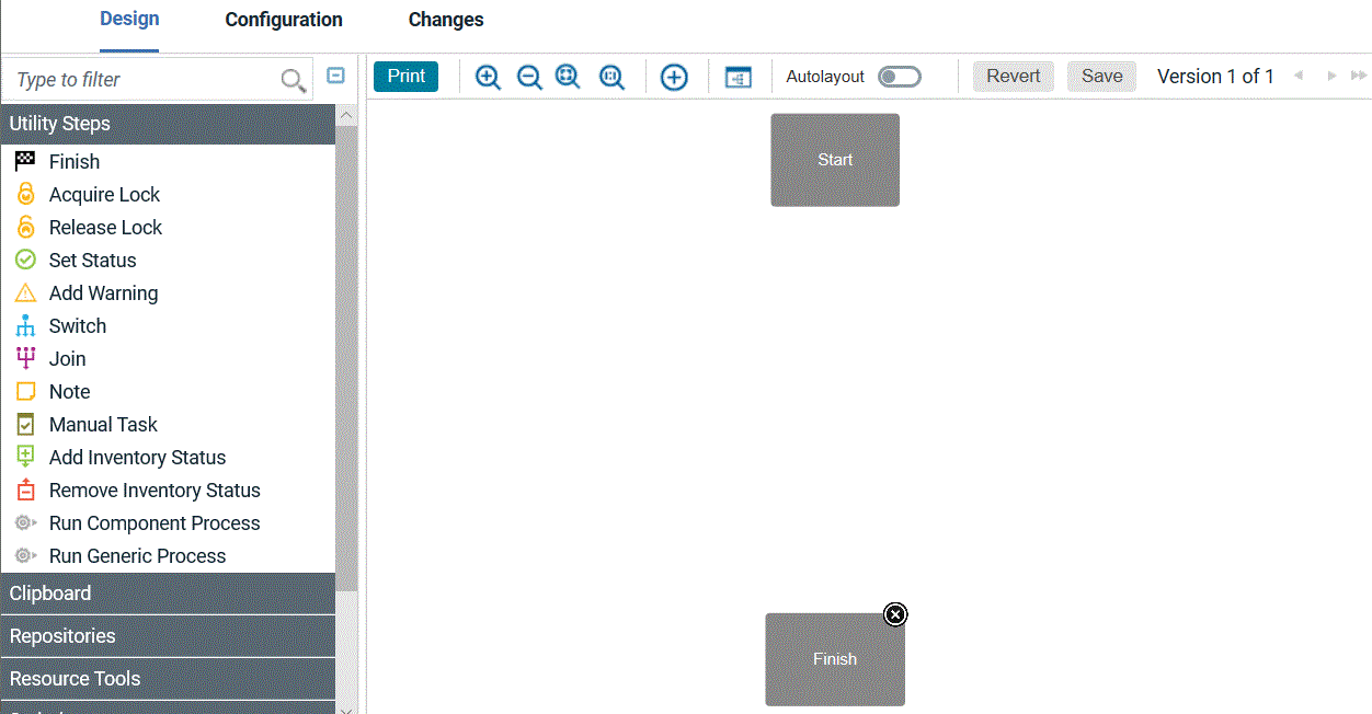

Open the helloProcess process editor and go to
Design.
The process editor lists plug-ins and steps. The required
Start
and
Finish steps represent the beginning and the end of the process and are
automatically placed on the design area. You add steps to the process by dragging them onto the
design area and arranging them between the
Start and
Finish steps.

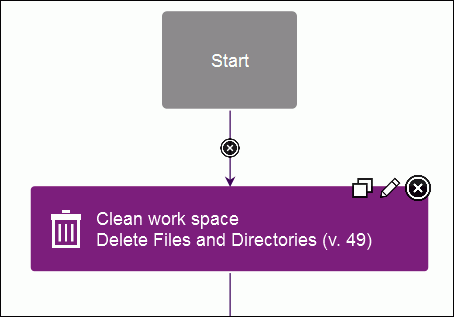

- Add a step that removes files from the working directory.
To ensure that the agent works with the most recent files, remove
files that remain from previous work:
In the Step Palette pane, click .
Click and drag the Delete Files and Directories step to the process
editor.
Click the edit properties icon
, and the
Edit Properties window opens, showing the properties for the
step. Some of these properties are unique to the step, and others are the same for all
steps.
- In the Name field, specify a
name, for example, Clean work space.
- In the Base Directory field,
specify a single period (
.).This value
resolves to the folder that you specified as the agent working directory.
Click the Include field, and in the Edit Text box,
specify an asterisk (
*); then, click Save.
This parameter instructs the agent to remove all files in the working directory.
Accept the default values for the other properties, and then click
OK.
The new step is displayed in the design area. Each step has two icons at the upper-right
corner of the step. Click the
Edit icon
to reopen the
Edit Properties window where you can modify the step
properties. Click the
X icon
to delete the step and connections to or from it.
The Start and Finish steps are
automatically connected to the step.

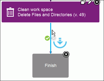

Click Repositories, and under Artifact/ HCL Launch drag the Download Artifacts step to the process
editor.
Be sure to highlight the connection arrow when you drag the step to the process editor so that
connection arrows are automatically inserted from the previous step to the Finish step. See the
highlighted connection arrow in this illustration:
Click the Edit icon
, and in the Edit Properties window, accept the default values; then,
click OK.
- Optional:
If you didn't highlight the connection arrow when you dragged the step to the editor, complete
these steps:
- Delete the connection arrow between the Clean work space step and the
Finish step.
- Draw a connection from the Clean work space step to the
Download Artifacts step, and then connect the Download
Artifacts step to the Finish step.
Tip: To manually connect steps, move the mouse over one step. The arrow icon is
displayed, as the following figure shows. You use this icon to connect steps to one another.
. Click and drag the arrow icon over the subsequent step. The direction of the arrow defines
the direction of the process flow.

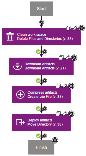

Except for connections from
Start, each connection has a
conditional flag. The conditional flag represents the process status that is required
before the connection can be followed. The connection is followed only if the originating step is
complete, and the specified condition is met. The possible conditions are as follows: success,
failure, or either. The default condition is success, which is represented by a green check mark, as
the following figure shows. In this example, the
Download Artifacts step is
started only if the
Clean work space step finishes with a success condition.
You can change the conditional flag by clicking the icon.

Save the process by clicking Save .
The complete process for the helloWorld component looks like
the following figure:
