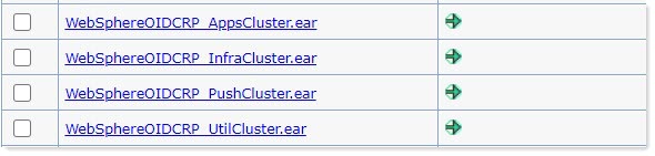

For every cluster, deploy WebSphereOIDCRP. To install the WebSphereOIDCRP application follow the instructions in the WebSphere documentation Configuring an OpenID Connect Relying Party and follow Step 1 in “Install the OpenID Connect application“ .
In this example, the Connections applications are installed across the four clusters, AppsCluster, InfraCluster, PushCluster, and UtilCluster.

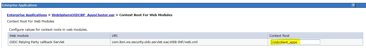

Apply a unique context root to each of the clusters. For example, for the Apps cluster, go to Enterprise Applications > WebSphereOIDCRP_AppsCluster.ear > Context Root For Web Modules.

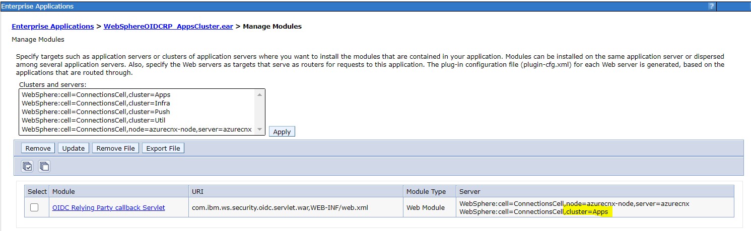

Apply clusters to each module. For example, for the Apps cluster, go to Enterprise Applications > WebSphereOIDCRP_AppsCluster.ear > Manage Modules

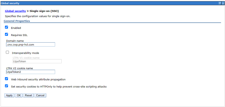

Configure Single Sign On Go to Security > Global Security > Web and SIP Security > Single Sign-on (SSO)

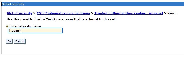

Configure the Keycloak realm as a trusted realm:
- Click Security > Global security > RMI/IIOP security > CSIv2 inbound communications > Trusted authentication realms - inbound.
- In the Realms section, click Add External Realm.
- For the External realm name field, enter the value for {realm}.
- Click OK.

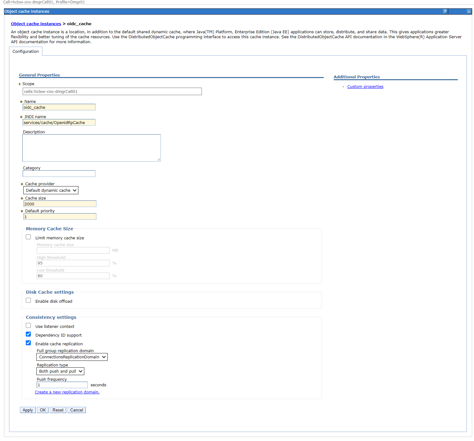

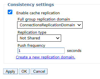

Create a new object cache instance with the JNDI name matching the one used in the last TAI property in the preceeding table.
- Go to Resources > cache Instances > Object cache instances.
- Set the name to oidc_cache
- Set the JNDI name to
services/cache/OpenidRpCache - Select Enable cache replication
- Set the Full group replication domain to ConnectionsReplicationDomain
Go to Application servers > cluster > Container Services > Dynamic cache service, and for each cluster’s dynamic cache service make sure that cache replication is enabled and uses ConnectionsReplicationDomain.

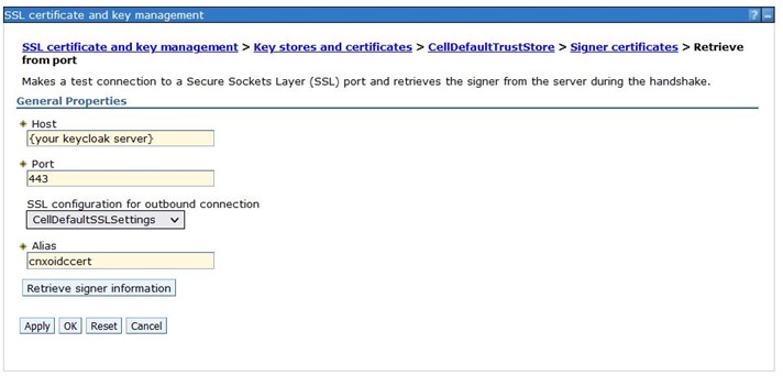

Add the root signing certificate of the Microsoft Certificate endpoint to the default trust store:
Go to Security > SSL certificate and key management > Key stores and certificates.
Select CellDefaultTrustStore and click on Signer certificates.
Click Retrieve from port.
For the Host field, enter {your keycloak server}.
For the Port field, enter 443.
For the Alias field, enter
cnxoidccert. (You used this name as a value forproperty provider_1.signVerifyAlias. ) -
Click Retrieve signer information.
Click OK and save the changes.
