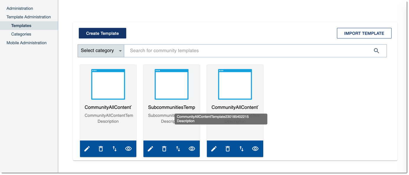

The deployment
community-template-serviceuses Mongo3. Before starting to migrate data from Mongo3 to Mongo5, the following three templates are created as follows:
As Mongo3 is in use, these templates are stored in the Mongo3 database.

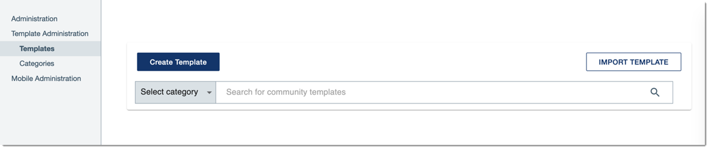

Since there is no data created and migrated in Mongo5 yet, the database used for
community-template-serviceis blank.
