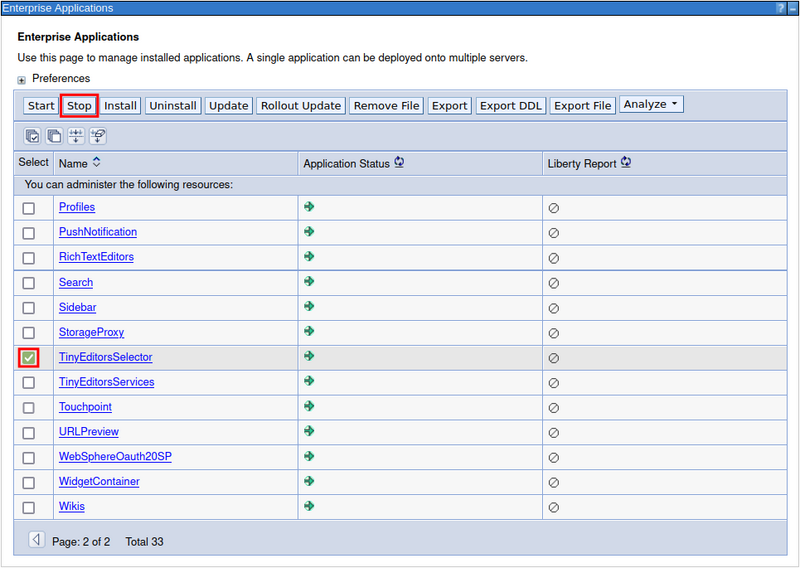

Navigate to Applications > Application Types > WebSphere enterprise applications.
Select the checkbox for TinyEditorsSelector from the list of applications and click Stop.

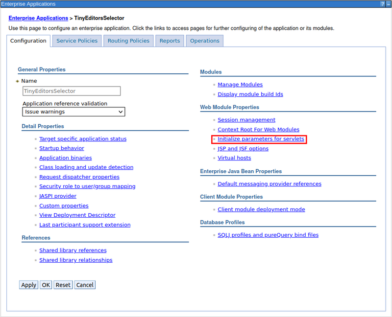

Find TinyEditorsSelector in the list of applications and click the TinyEditorsSelector link.

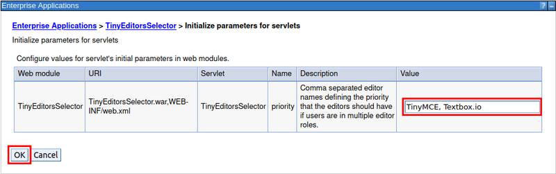

On the Configuration tab, click the Initialize parameters for servlets link.
Set the priority value to "TinyMCE" in any order separated by a comma then click OK.

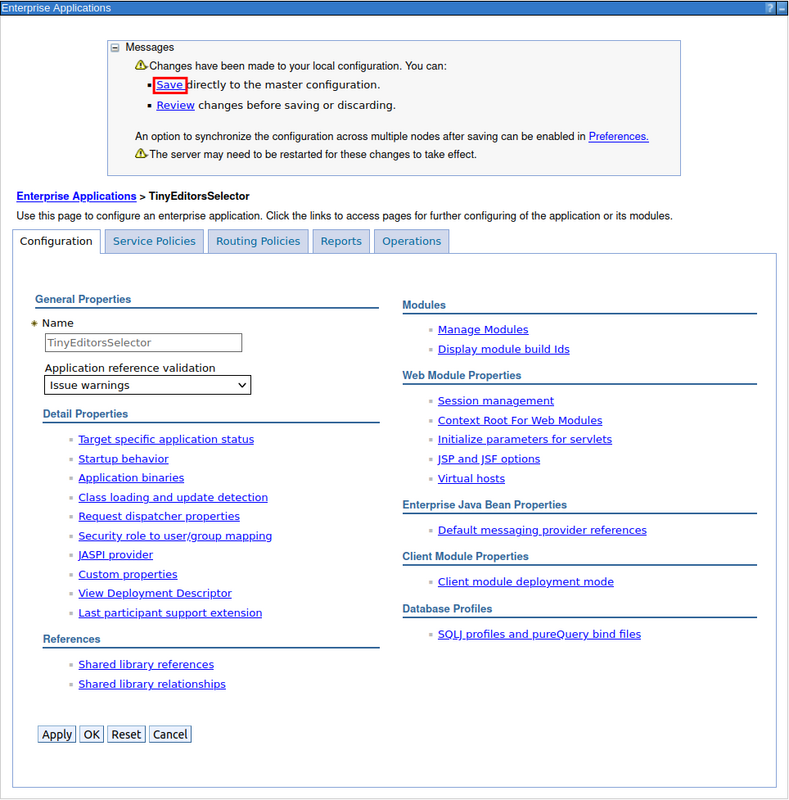

Click Save to save the change.
Select the checkbox for TinyEditorsSelector from the list of applications and click Start.
