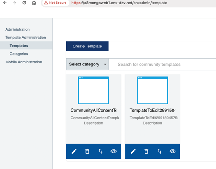

On your Mongo3 environment, note any community templates you previously created. This information will be helpful in later on verifying that migration succeeded, as you will need to check for the same community templates after migrating the database to Mongo5. For example, in an environment using Mongo3 we created two community templates as shown in the following image:
After a successful migration, the same community templates should appear for the Mongo5 environment, as described in the verification section.
If the migration failed, these templates would no longer be visible.

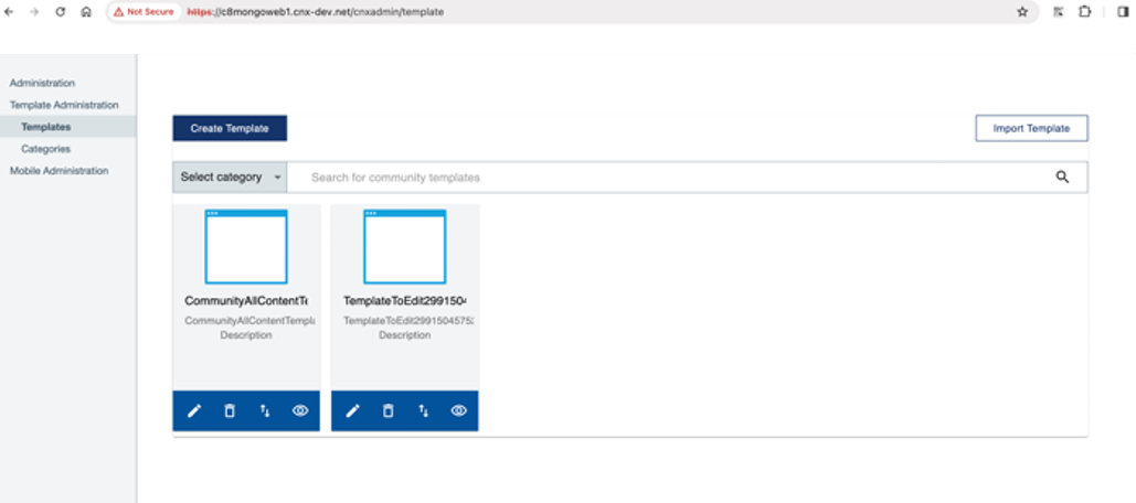

Ensure that the previously created community templates are migrated successfully and displayed in the user interface. For instance, the community templates shown in the earlier example are still in the new Mongo5 environment, as shown in the following image:
