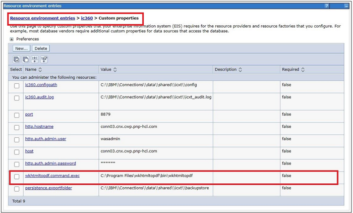

Enter the WebSphere administrative console (e.g.: https://your.dmgr.host:9043/ibm/console) and navigate to
Resources > Resource Environment > Resource Environment entries -
Look for the
ic360resource environment entry and click on it -
Navigate to
Additional Properties > Custom properties -
Click New... to create a new property
Enter the name
wkhtmltopdf.command.execand the path to the wkhtmltopdf binary (including its name) as the value, e.g.C:\Program Files\wkhtmltopdf\bin\wkhtmltopdf.exeon Windows or/opt/HCL/Connections/wkhtmltox/bin/wkhtmltopdfon Linux. -
Click Apply and OK.
Save the changes to the master configuration.
Restart ICXT server.

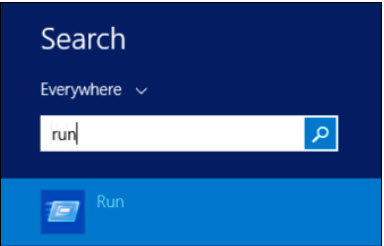

Login as Administrator and Click "Start"
Search for "run"

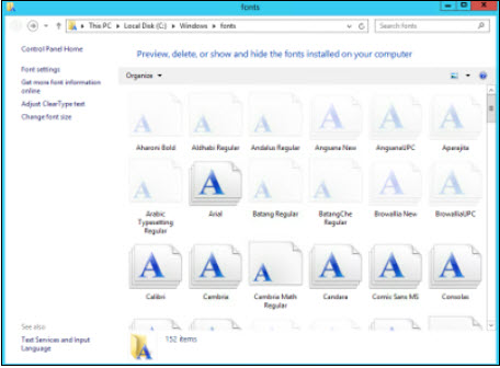

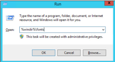

- Enter
%windir%\fonts

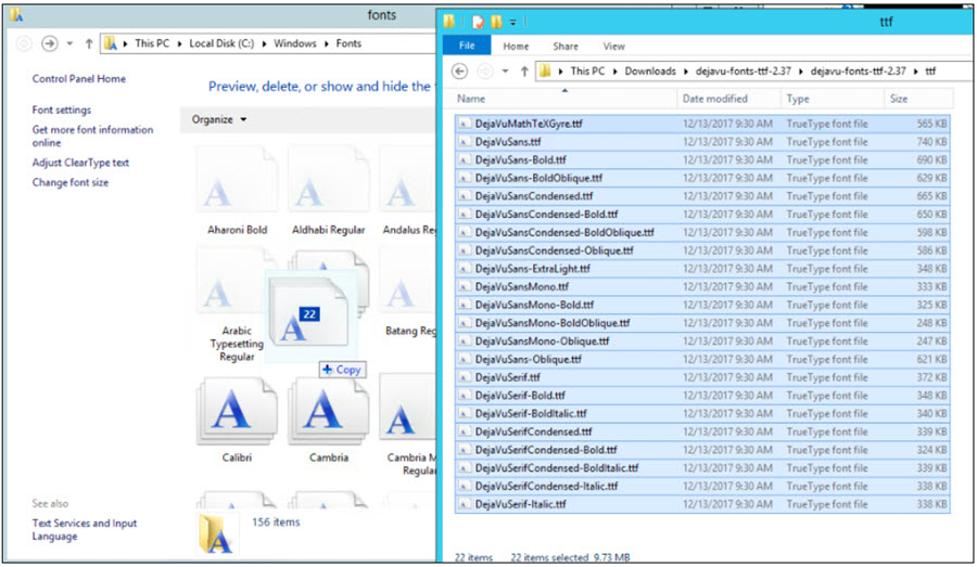

- Drag and drop the extracted fonts from the ttf folder to the Fonts config window
