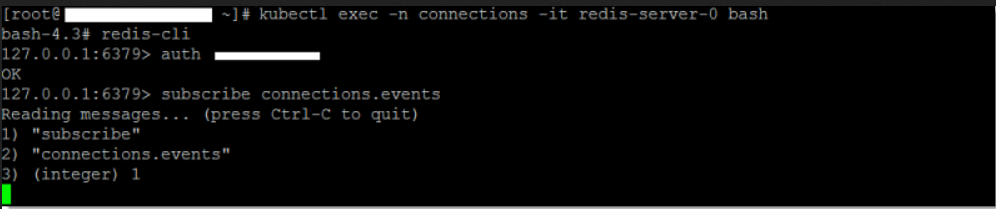

Subscribe to the
connections.eventschannel. -
To subscribe to the Redis
connections.eventschannel you must first connect and authenticate with the password (secret) set during bootstrap installation.Note: If you configured SSH tunnelling, validate that the SSH Tunnel is working before you connect to the running Redis pod on the master server.
Connect to the Redis server:
redis-cli -
Authenticate with the server:
auth redis-password -
Subscribe to the channel:
subscribe connections.events
For example:

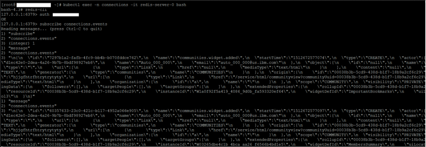

Validate that events are populated in the connections.events channel
Follow these steps to validate that events are populated in the connections.events channel.
Keep the channel from the previous step open, and browse to the home page of your Connections server.
Log in as a user with rights to create a community.
Create a community, then switch back to the Redis pod. You should see events being posted in the channel.
For example:
