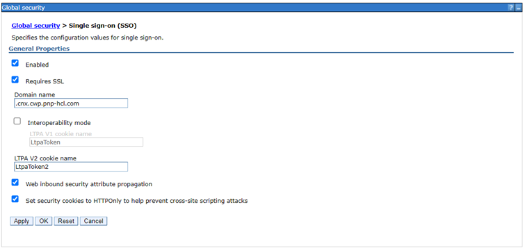

  4. Configure Single Sign-on Go to Security > Global Security > Web and SIP Security > Single Sign-on (SSO)

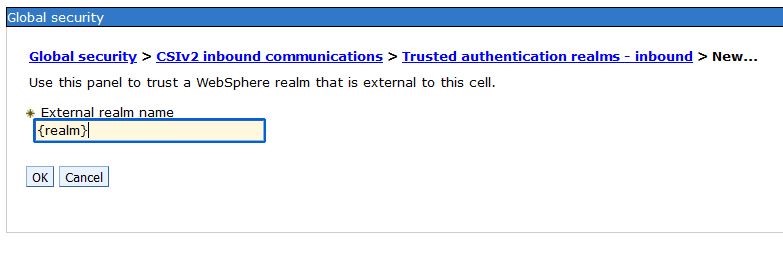

  13. Configure the trusted realm:
    1. Click Security > Global security > RMI/IIOP security > CSIv2 inbound communications > Trusted authentication realms – inbound.
    2. Click on Add External Realm.
    3. In the External realm name field, enter the value for provider_1.issuerIdentifier from the Interceptor.
    4. Click OK.

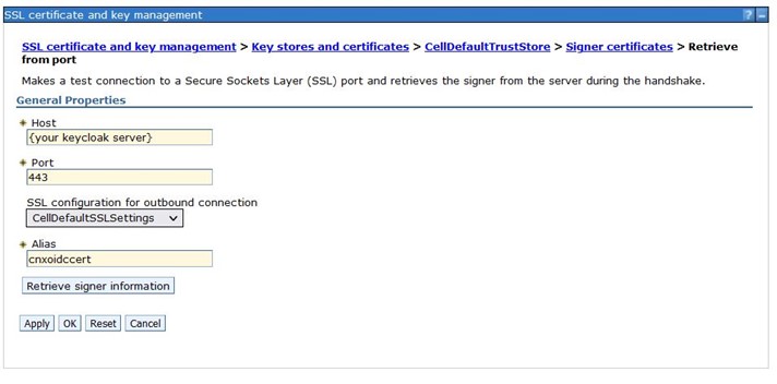

  14. Add the root signing certificate of the Microsoft Certificate endpoint to the default trust store:
    1. Go to Security > SSL certificate and key management > Key stores and certificates.
    2. Select CellDefaultTrustStore and click on Signer certificates.
    3. Click Retrieve from port.
    4. For the Host field, enter {your keycloak server}.
    5. For the Port field, enter 443.
    6. For the Alias field, enter cnxoidccert. (You used this name as a value for property provider_1.signVerifyAlias. )
    7. Click Retrieve signer information.
    8. Click OK and save the changes.
