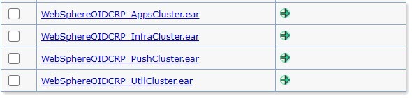

  1. For every cluster, deploy WebSphereOIDCRP. In this example, the Connections applications are installed across the four clusters, AppsCluster, InfraCluster, PushCluster, and UtilCluster.
    WebSphere screen showing WebSphereOIDCRP associated with four cluster names

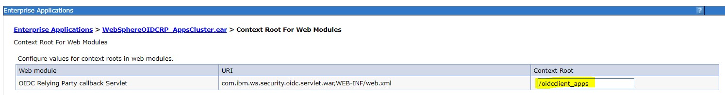

  2. Apply a unique context root to each of the clusters. For example, for the Apps cluster, go to Enterprise Applications > WebSphereOIDCRP_AppsCluster.ear > Context Root For Web Modules.
    Applying context root to cluster

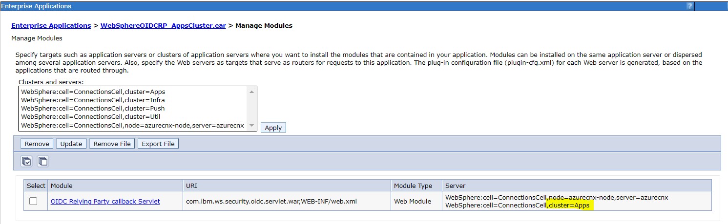

  3. Apply clusters to each module. For example, for the Apps cluster, go to Enterprise Applications > WebSphereOIDCRP_AppsCluster.ear > Manage Modules

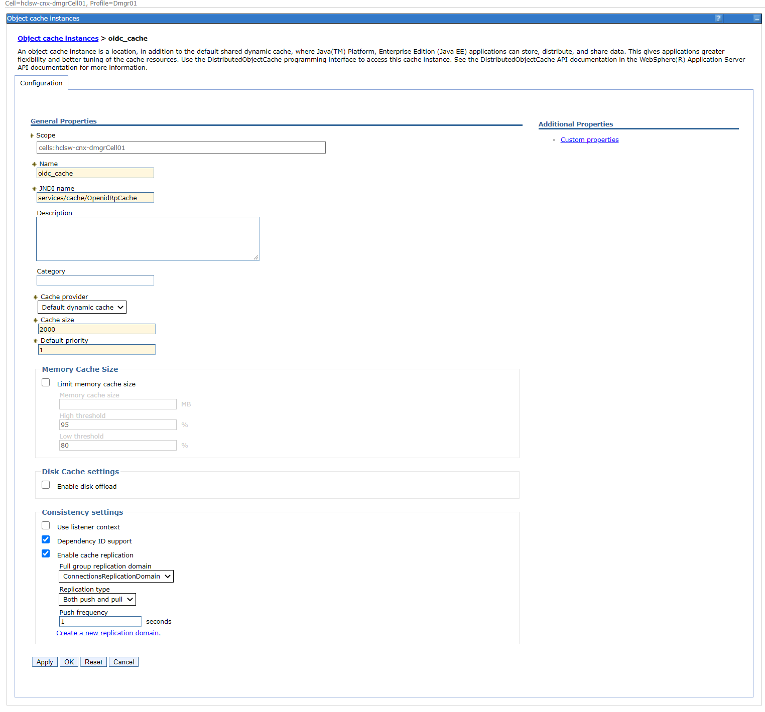

  11. Create a new object cache instance with the JNDI name matching the one used in the last TAI property in the preceeding table (Resources > cache Instances > Object cache instances).
    screen for creating cache instance
  12. Go to Application servers > cluster > Container Services > Dynamic cache service, and for each cluster’s dynamic cache service make sure that cache replication is enabled and uses ConnectionsReplicationDomain.
    screen for enabling cache replication
